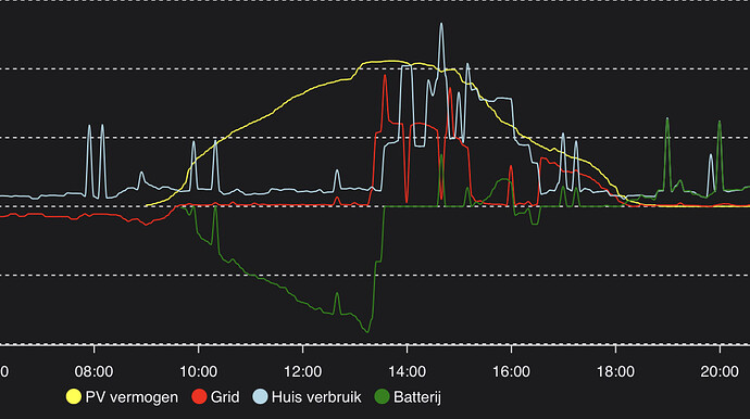

I believe it is the case… this is the chart I’ve made of the values how they are.
So this means I need to change the values to positive or how to adapt?
Yes, for you the current delivered to the grid is positive so the charging control logic fails the way you describe.
You must either inverse the grid power calculation, or you must change the charging control logic.
The charger control logic has two actions; one to step the current up (when the grid power is below -250W) and one to step the current down (when the grid power is above 250W). You should change that to step the current up (when the grid power is above 250W) and step the current down (when the grid power is below -250W).
Success!
Below is my set-up. If you swap the ’ below “-250” ’ and ’ above “250” ’ statements you should be good.

So it seems to be working after adapting it. Only thing I was wondering the logic of pause and resume. Because when you are charging the export is low. So when I set it to below 250… it goes to pause because it is charging. So I set it to 0 and when going below it… it goes in pause. Time I adapted to 3min because it takes 120 to go from 16A to 6A.
What I notice is that when it went in pause and resumes… the Amps are set to high and seems not to adapt until I push on green, then it starts from 6A…
One issue is the fact I have a battery so when I use more than PV generation then the battery comes in… so this needs also to be adapted from the moment the there’s a discharge on the battery it goes in pause.
Any suggestion?
I assume your battery starts taking power when there is excess solar power available. So the battery and the car charger compete for this power. That can led to some strange instable controller behavior. Probably the car should take priority.
Since you know the power taken by the battery you could control the EVSE based on the sum of the grid and battery current.
Mind your power directions, your grid power is positive when absorbing power, but you battery power is negative when absorbing power.
Made a simple trigger when the battery is discharging for 2min and the EV is charging to put Wallbox in pause. After that it will resume based on the excess of PV power
