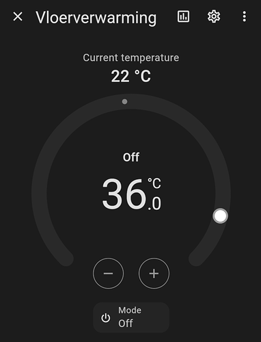

For me, the temperature shows up correctly and can be altered, but you cannot change mode or turn the thermostat on and off.
I’ve created an issue here: Tuya C16 Wi-Fi Thermostat control partially not working · Issue #132196 · home-assistant/core · GitHub

Just as in the thread I use the integration Tuya local. But for example when I try to change the heating mode I receive an:
Failed to perform the action climate/set_hvac_mode. hvac_mode is read only
Might be similar to the behavior of @Humvee ?
