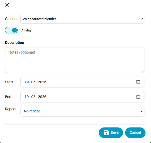

After clicking on event, I get an dialog window without summery information.

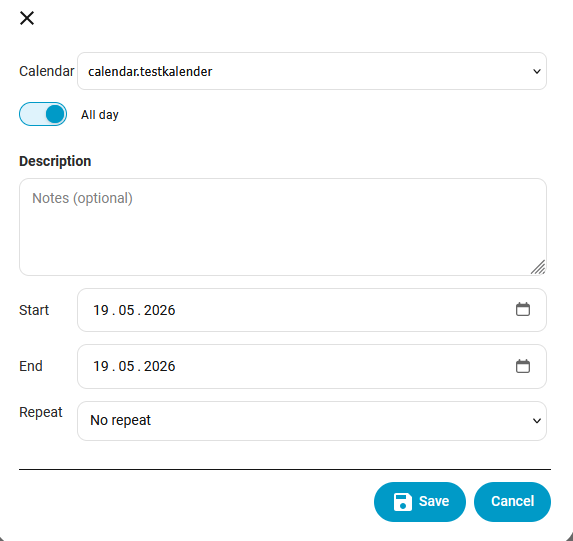

After click Edit the following dialog:
What am I doing wrong?
I will take a look, Maybe HA update broke something? Will report back when i get a chance to look(within 12 hours)
@SohnVonRobotron Try updating to version 2.0.9. let me know how that works for you.
Sorry, don't work. The dialog is a little bit different.
There is no field for title/summary.

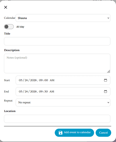

@SohnVonRobotron v2.0.10 has Title and also Location back. strange why they no longer displayed but should be good now.
The dialog box seems to be correct now. I'll test everything thoroughly over the weekend.

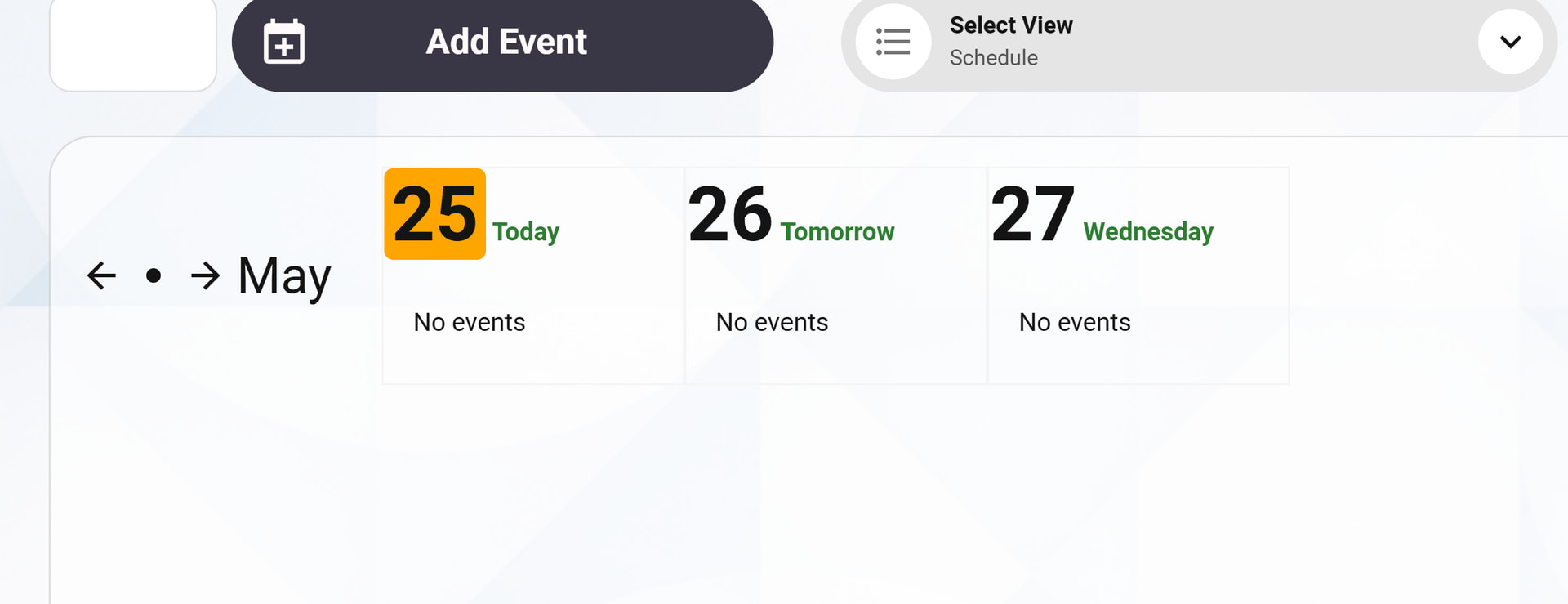

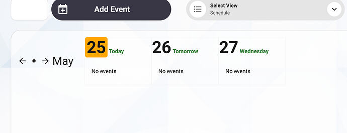

I've been struggling to get the schedule view to work. I've tried a few times, started over but I can't seem to get it working. I'm on 2.0.10 but the issue has been the same for several versions now. I seem stuck with the grid view no matter what I've tried. Right now regardless of the view I select none of my calendar entries show. Previously I had to update this to get them to show.
return 'monday'; // <--- UPDATE THIS IF NEEDED, valid values are: monday, tuesday, wednesday, thursday, friday, saturday, sunday
I'm not sure what's needed to help figure this out but I would appreciate if someone could help me out.
You edited proper files? Should work if you did. Perhaps you can try opening in browser with incognito enabled or clear cache on your browser. Also if you provide your yaml setup it may point to any issues. I few posts up explain what’s needed to get that view working.
I must have made things worse for myself, I found the issue. Along the way I changed viewmode and removed ${ VIEWMODE }.
Put that back and it's now working. Thanks for putting this together, the entire family loves checking the schedule. Now it's time to add some chore tracking :slight_smile:
