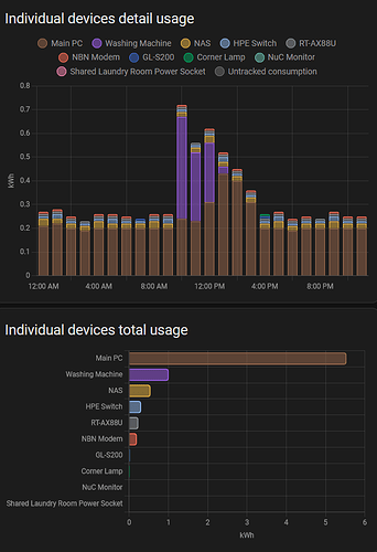

That negative usage is very strange I have not seen that happen with my setup even using the generic TS011F plugs as it all shows as it should atm for per device power tracking:
