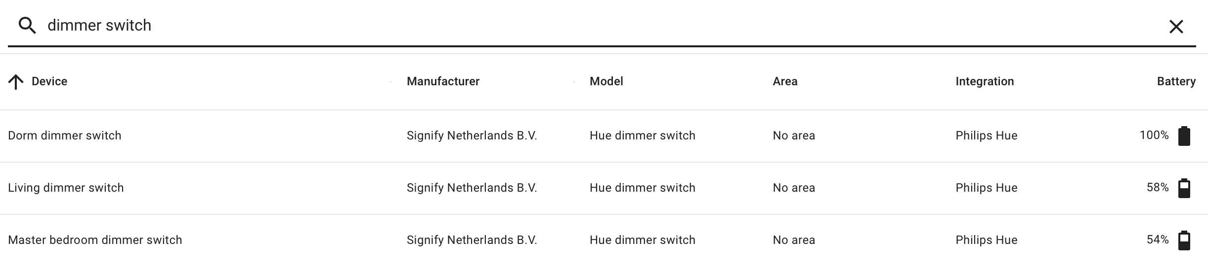

they are visible in the devices:

There is, but it’s only for the battery level. Based on your screenshot from the Devices page you should see sensor.dorm_dimmer_switch_battery_level, sensor.living_dimmer_switch_battery_level, etc. If you click on each of those devices you should see the underlying entities. Dev Tools > States would also show them.

yes I have these sensors, but they are made by the CC, and not the Hue core integration.
sorry missed that. And yes, they are there:
good to know because hue_event isn’t listed in the right side of the event page
The second screenshot says Philips Hue for integration, so those are the sensors generated by the Hue integration.
Haha no worries. I was anyway just guessing :slight_smile: I’m also a big Hue user but not with the official integration, deconz is way better for my needs :slight_smile:
the second screenshot shows devices, not sensors… hence my question. Ive check the states for _2 sensors, and that is not the case.
I have sensors for battery_level only made by Philips Hue integration, all other sensors are made by the CC, or myself as template sensors (for battery, based on the CC)
Right. Click on each of those devices to see the underlying entities. The official Hue integration only generates battery entities. The ones ending with battery_level are the ones the Hue integration is generating (I made a mistake in one of my previous posts, I’ll edit accordingly).

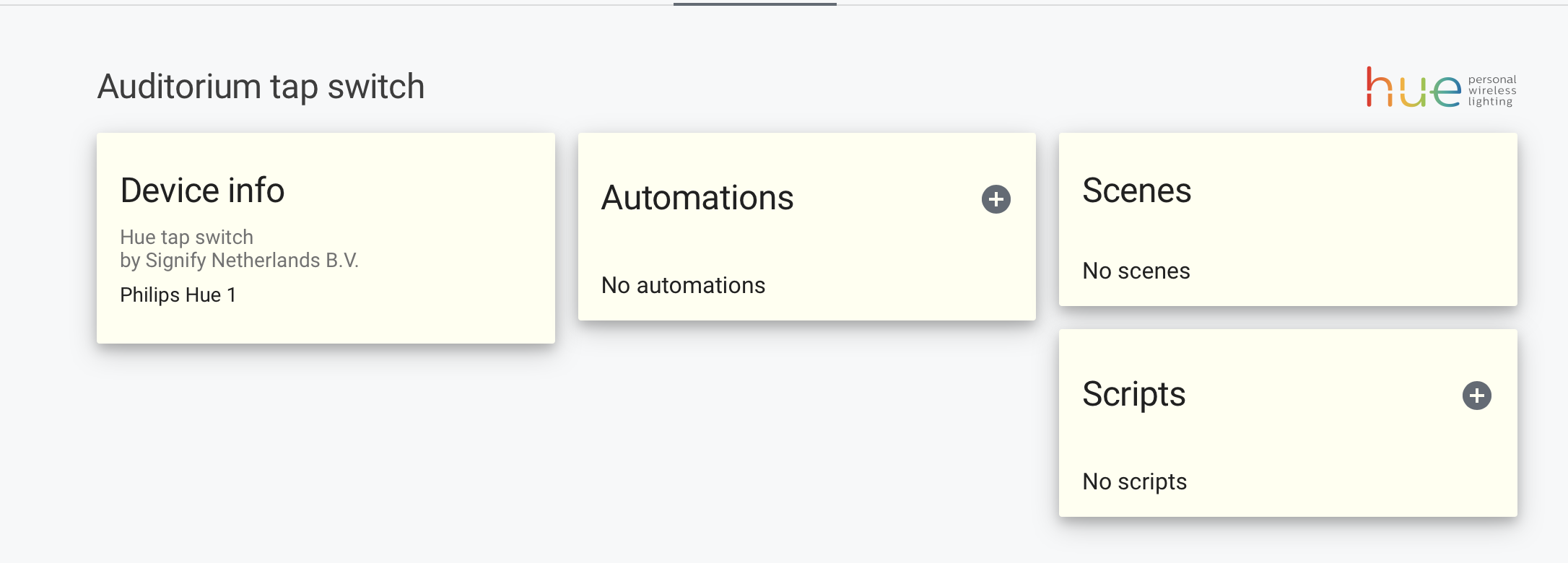

exactly, as I feared: this is a click on the device:
no entities
Ah. Maybe the tap switches specifically aren’t included. Would make sense since that doesn’t have a battery. I’d check for events from it though.
no need, that was what I posted in the first post :wink:
tap switches dont have batteries of course, so no battery_level sensors.
