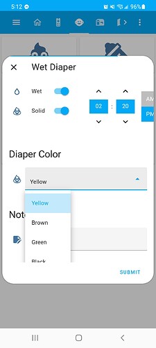

Main interface with input buttons and data
Change Button pulls up an interface to be able to set the time, type, color, and notes. Color is hidden when Solid is not checked.
The feeding button allows us to set the method, food type, amount, time, and notes. Amount is hidden when anything but Bottle is selected.

YAML For the Change and Feed Buttons:

  - type: custom:button-card
    icon: mdi:emoticon-poop
    color_type: icon
    color: rgb(68, 115, 158)
    show_name: false
    tap_action:
      action: fire-dom-event
      browser_mod:
        service: browser_mod.popup
          title: Wet Diaper
          timeout: 30000
          right_button: Submit
          right_button_action:
            service: automation.trigger
              entity_id: automation.baby_buddy_diaper_automation
          content:
            type: vertical-stack
            cards:
              - square: false
                columns: 2
                type: grid
                cards:
                  - type: entities
                    entities:
                      - entity: input_boolean.bb_diaper_wet
                      - entity: input_boolean.bb_diaper_solid
                  - type: custom:time-picker-card
                    entity: input_datetime.bb_diaper_time
                    hour_mode: 12
                    hour_step: 1
                    minute_step: 5
                    second_step: 5
                    hide:
                    link_values: true
                    layout:
                      embedded: false
              - type: conditional
                conditions:
                    state: 'on'
                card:
                  type: entities
                  entities:
                    - entity: input_select.bb_diaper_color
                  show_header_toggle: false
                  title: Diaper Color
              - type: entities
                entities:
                  - entity: input_text.bb_diaper_notes
                title: Notes

I labelled this as a WIP because I am not totally happy with where it’s at:
  • There are other services I would like to include, like the Delete Last Entry service
  • A better way to handle total counts. The guide reference got total counts via templates, but they were not working for me. I may end up scraping the values from the BabyBuddy admin page, because I think it will be too complicated to account for deleting entries and updating the proper counter
  • I would like the time cards to update with the current time when opening the popup card, but have not gotten around to implementing that yet.
  • Rely less on helper entities
  • The helper automation to keep the end time for feeding up to date with the start time works until rolling past midnight, at which point I have to roll the end time up past midnight so it once again equals to before the start time. Should be simple to fix > when start time = midnight change end time to midnight.
Apologies if this is a bit confusing to follow, I am somewhat sleep deprived for obvious reasons :slight_smile:

I’m working on building off of your setup here but using the Home Assistant UI Subviews 2022.10: All over the place - Home Assistant
I’ll share when I’m done!
There was an update to the base addon docker image, that update was just pushed out so you should see it soon, let me know if it helps!
:frowning: Thank you, I tested it and posted the error message on the GitHub issue docker build error related to dependencies? · Issue #21 · OttPeterR/addon-babybuddy · GitHub
Thank you for your hard work here, you inspired me to make my own too!
I’ve created something similar and documented it here as a blueprint and screenshot of my dashboard:
@OCT0PUSCRIME let me know what you think!
This looks great! Glad to see you took it further than I did and implemented more options like pumping, sleep and tummy time timers! I have slowed down my use of Baby Buddy in the last few weeks, but it was integral during the first couple of months. I will definitely reference back to this once I am on baby #2 lol.

hi, I am unable to get the “count” working. Also, I don’t really understand what you mean by “XYZ yaml” – are these all in configuration.yaml? Automation.yaml? Somewhere else? I am using the Blueprint you created and it requires the “Counter” as a mandatory field. I don’t know what I need to type in which file to get counters to work. Super n00b here.
I have a work-around for the counters that actually pulls the true count from the BabyBuddy add-on via the API. There have been some requests for additional sensors as part of the HA integration, but it’s one person working on it and I’m sure it’s not his only project. Unfortunately, I have no experience working on HA integrations so I couldn’t be much help. However, I used the API in Node-RED to pull the additional information I need, including exact counts of things. I created a separate forum post, since it’s a different way of doing things.
I know this is old but here are my rest sensors for getting the day’s changes/feedings/pumping, for anyone who comes across this.
rest:
  - resource_template: http://yourbabybuddy/api/changes/?date_min={{ now().strftime('%Y-%m-%d') }}
    headers:
      Authorization: Token yourapikey
    scan_interval: 60
    sensor:
      - name: BB Diapers Today
        value_template: "{{ value_json.count }}"
  - resource_template: http://yourbabybuddy/api/feedings/?end_min={{ now().strftime('%Y-%m-%d') }}
    headers:
    scan_interval: 60
    sensor:
      - name: BB Feedings Today
  - resource_template: http://yourbabybuddy/api/pumping/?end_min={{ now().strftime('%Y-%m-%d') }}
    headers:
    scan_interval: 60
    sensor:
      - name: BB Pumpings Today
It basically uses the BabyBuddy API, and uses today’s date as the minimum date to grab results. You can add more sensors to calculate stuff like average amounts today or something.
You can also play around with the query options to extend to the last week/month too.
Hope it helps!
