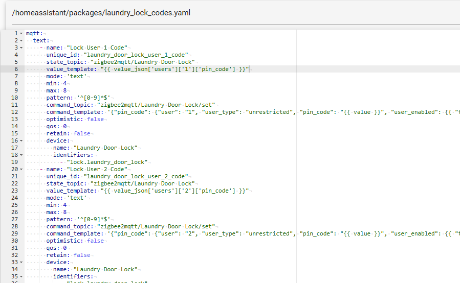

The first step is to set up mqtt entities in your configuration.yaml file for both the user code (i.e. number) and the code status (i.e. enabled/disabled), for which I use text and switch entities respectively. You can set up as many different users as you like, but I went with the two permanent residents and two extra guest codes (more on those below). I also set them all to be the same device at the automatically set up mqtt device, but unfortunately (although it does group them) it doesn’t appear that you can add them to an existing device.
configuration.yaml additions (duplicate and renumber for more users)
mqtt:
text:
- name: "Lock User 1 Code"
unique_id: "front_door_lock_user_1_code"
state_topic: "zigbee2mqtt/Front Door Lock"
value_template: "{{ value_json['users']['1']['pin_code'] }}"
mode: 'text'
min: 4
max: 8
pattern: '^[0-9]*$'
command_topic: "zigbee2mqtt/Front Door Lock/set"
command_template: '{"pin_code": {"user": "1", "user_type": "unrestricted", "pin_code": "{{ value }}", "user_enabled": {{ "true" if states("switch.front_door_lock_lock_user_1_code_status") == "on" else "false" }} }}'
optimistic: false
qos: 0
retain: false
device:
name: "Front Door Lock"
identifiers:
- "lock.front_door_lock"
switch:
- name: "Lock User 1 Code Status"
unique_id: "front_door_lock_user_1_code_status"
value_template: "{{ value_json['users']['1']['status'] }}"
state_on: "enabled"
state_off: "disabled"
command_template: '{"pin_code": {"user": "1", "user_type": "unrestricted", "pin_code": "{{ states("text.front_door_lock_lock_user_1_code") }}", "user_enabled": {{ value }} }}'
payload_on: "true"
payload_off: "false"
optimistic: false
qos: 0
retain: false
device:
identifiers:
