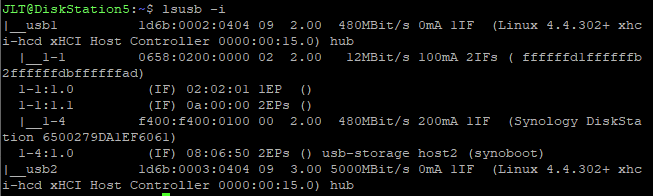

Run lsusb -i before doing this and capture the output, then run it after the command runs and capture the output. Post that here.

here is the result of the command lsusb -i :

You need to ssh into the Synology box and run lsusb from the ssh command prompt.
Ok, here is the command line response :
That 0658 device is the Gen5 stick, it is not configured correctly. Do this

It should look more like this, you can see the cdc_acm driver is loaded and the device it mapped to ttyACM0
