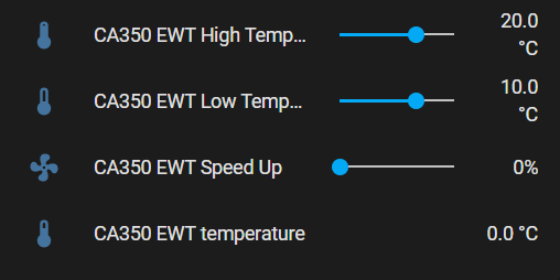

I’ve started to work on EWT support. You can already check the dev branch adorobis/hacomfoairmqtt at dev (github.com) it should already read the EWT temperature sensor and expose 3 number entities (low temp, high temp and speed up %) but without reading or controlling it yet. I’ve also renamed the script to ca350.py for better recognition by text editors.
Edit:
@brechtvhb
The dev branch has now the controls implemented as well. Once you run it you should see additional entities in the comfoair device:
Below is also a piece of info from configuration, based on which I’ve defined min and max values of the parameters (P61-63):
You can test now and let me know if it works as expected. I don’t have the EWT so it is quite hard to test it, although the unit still accepts and reports back those settings.
