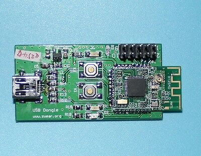

Would this device work?
It claims to be a CC2531, but hooks up via Micro USB Cable, instead of having a USB Type A connector, which I prefer.
It depends if they used the reference design for the buttons and LED. Looks like it should work though.
