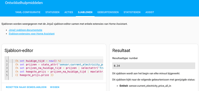

Hi, I can’t get this code working. Most values are empty.
I don’t know what to change.
hi @BasPost
you can debug by start checking the sensor results;
If sensors are working cut&paste the template in the template editor;
I hope this will help you to find your issue.
