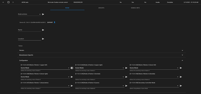

when I go to configuration there is nothing selected:
I selected scene and pressed the arrow for the 4 buttons but nothing changes.

You need to wake up the remote for the settings to be accepted.
i’m confused. I thought my screen shot showed that the remove is awake. I did that by pressing the join button.
From my experience, one you wake it up, zwave-js will not show it going back to sleep until you send a command. The minimote will never say it goes to sleep. So if you wake it it may have gone to sleep.
You may have to set the settings multiples times. The UI will also not show the value because a Get is never sent. You just have to set the values and hope it works.
If it doesn’t work, try setting the buttons in multiple passes, e.g. set buttons 1 and 2, wake, wait for a bit, then set 3 and 4. It took me several tries in the past.
It’s easier if you watch the zwave_js.log file to see if it sent the Configuration commands (may depend on your logging level). The file is accessible from the zwavejs2mqtt UI.
no luck
