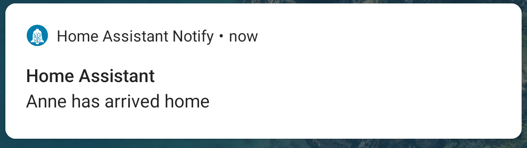

- service: notify.android
    message: Anne has arrived home
This will send a simple push notification without any action buttons.

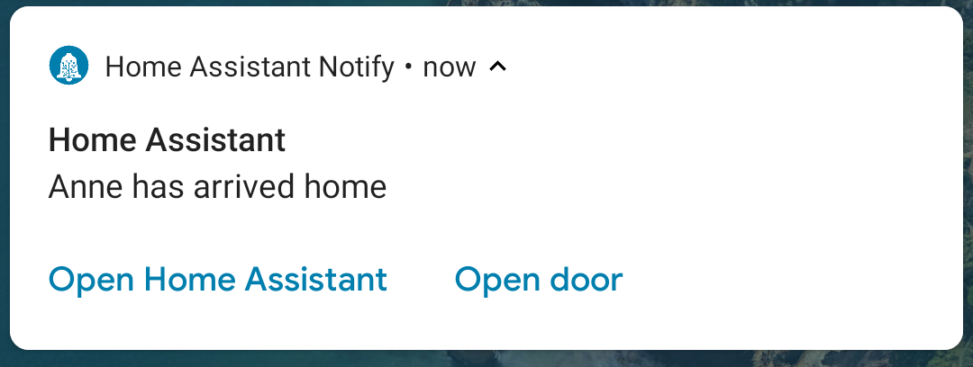

If you want to include some actions, something like this will work:
      actions:
        - action: open
          title: Open Home Assistant
        - action: open_door
          title: Open door
This will have two buttons, one that says “Open Door” and one that says “Open Home Assistant”. The action for each button (“open” or “open_door” in this example) will be returned in the callback.
