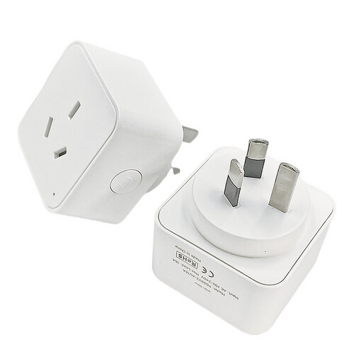

After having various other smart plugs fail after 1-2 years (namely Kogan and Brilliant), I’m trying my luck with Athoms.
It would be great if other Athom smart plug users contributed too so we can easily track performance.
Mine have been running from a few days ago (01/12/2022). I have the AU plug v2. The AU ones aren’t currently certified.

I have six running. Australian plugs.
2 added 8 July 2022 (pool pump and dishwasher)
2 added 25 August 2022 (washing machine and dryer)
2 added 16 October 2022 (kitchen fridge and mancave fridge)
So easy to set up, and they rejoin the network without fuss if there is an outage. The inbuilt energy accumulation meter seamlessly works with the HA Energy Dashboard.
Hope they last because I dislike the Arlec/Tuya plugs I have. Such a pain to set up Tuya and LocalTuya, and when something goes awry it’s hours of troubleshooting. Plus they just never seems to connect as reliably.
Main downside is the form factor, they are 2-3 mm too wide to fit side by side in a double GPO.
