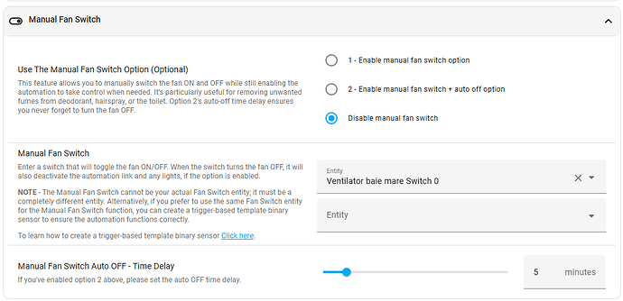

so for this fan i have a push button to control it, so i want to use this push button every time i think it’s necessary.
but with the current setting when i press the PB (shelly 1PM) the shelly start to flicker very fast on/off i don’t think it’s suppose to work like that.
i don’t know what option to use ?
if i disable both like in screenshoot fan works, but i need to set a working time like 5min when i press PB.

@MAdbUSU
I try and explain.
Your Fan is switch.ventilator_baie_mare_switch_0.
Your Manual Fan Switch is switch.ventilator_baie_mare_switch_0.
When you turn ON your manual switch the fan runs for 5 min as per your settings.
When the automation turns the fan ON it is the same as the manual fan switch, so it activates the manual fan switch and it runs for 5 min. This is what you are seeing.
If you would like to use the same entity for the fan and manual fan switch input then I do have a solution for your click here. It will show you how to do this. You will need a file editor to access your config file, click here as HA shows you how to do this.
Also note you can not use areas or devices in the fan input.
Blacky :smiley:
