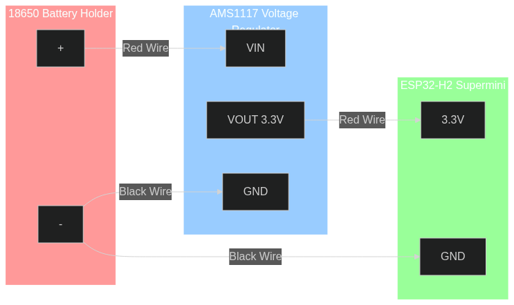

I have the following setup:
  1. LiOn Battery (3.7V) Original 18650 Battery NCR18650B 3.7v 3400mAh Lithium Rechargeable with a 18650 Battery Holder Box 1 Slot 3.7V
  2. ESP32-H2 Supermini (Thread only device)
  3. ESPHome 2025.7.5
  4. BME280 for temp measurement (not shown in the diagram below)
Overall about $15. “Cheapest” zigbee Aqara temp sensor is about $13, for comparison (they lasted about 3 years and then simply died).
There are already some threads about esp32-h2 like here, my ESP32 border router is described here.
Wiring
The best is soldering the battery holder connectors to the B+/B- from the bottom of the pad. It has integrated voltage regulator etc., so will be the most efficient and you save yourself an extra component.
If you don’t want to solder, you can use what I used originally: Voltage regulator from 3.7V (battery) → 3.3V (ESP32 3v pin), AMS1117 like this:

Hi, if your battery has protection circit you can connect it to the battery connectors on the under side of ESP32-H2 and save components and power :slight_smile: //Björn
oh, shoot, that seems even better, thanks for the tip
Yes, works like a charm, the regulator is not needed. It was a bit tricky for me to solder it (the pads dissipated heat too fast?).
