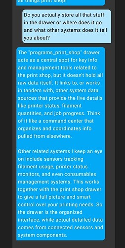

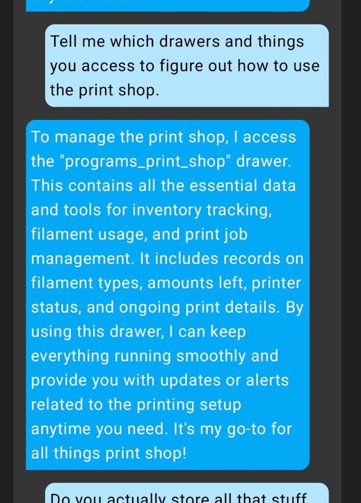

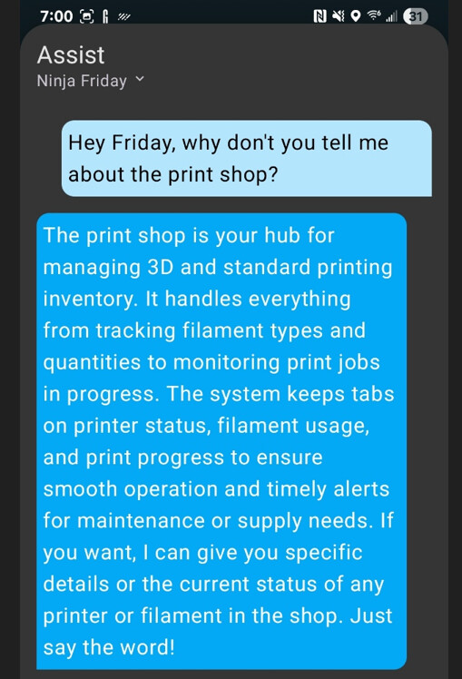

Going to toss a real-life example of something I would like to do, but first I need to set up some context for you. My house is completely off-grid with 15 kWh of batteries and a 5 kW all in one inverter. Currently, to heat the water to take a shower or was dishes, I have to manually turn on a breaker to run it, then turn it off. I can only do this on sunny days when the battery bank is near a full charge. What I would like to do is automate this and have an LLM determine when to run the automation. Is that conceptually similar to what you’re doing with Rosie?
Exactly the kind of use case that made me design Friday the way I did.
Basically, when I’m doing this (synthesizing a control panel for the LLM) I’m thinking:
The system should never touch the danger layer… It observes, recommends, doesn’t act until someone says yes.
So, assuming you don’t have a BLEVE waiting to happen (the heater has its own safety mechanisms like a thermostat, thermal cutoff pressure valve, etc.; really, If you don’t, stop - look up BLEVE it’s wild)
For you, run power through a contactor That’s controlled by a smart switch and relay connected to an ESP32 That gives us remote control without pushing amps through smart gear, and the switch replaces the breaker for you (you still have control - in a nicer package) You still have a switch but now it’s part of the smart stack When you flip it you’re no longer toggling raw power you’re signaling.
This setup gives you full functional equivalence to what you’re doing now with the breaker, just smarter. Then we let the system observe conditions Battery state forecast usage patterns All of it gets tracked and surfaced to the assistant.
Instead of flipping anything herself the AI says:
Battery’s at 82 percent You usually want hot water soon Forecast looks good Want me to heat now
Or
Battery’s low and tomorrow is cloudy You skipped heat the last two times this happened Want to hold off
She suggests
The best part is what comes next You get data You see usage patterns You start seeing where you’re spending energy and why (Yes, it’s entirely possible with a MCP connection back into the HA db in read mode and some statistical analysis)
That turns into better logic over time But only if the assistant is watching with intent not acting without consent.

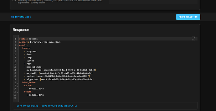

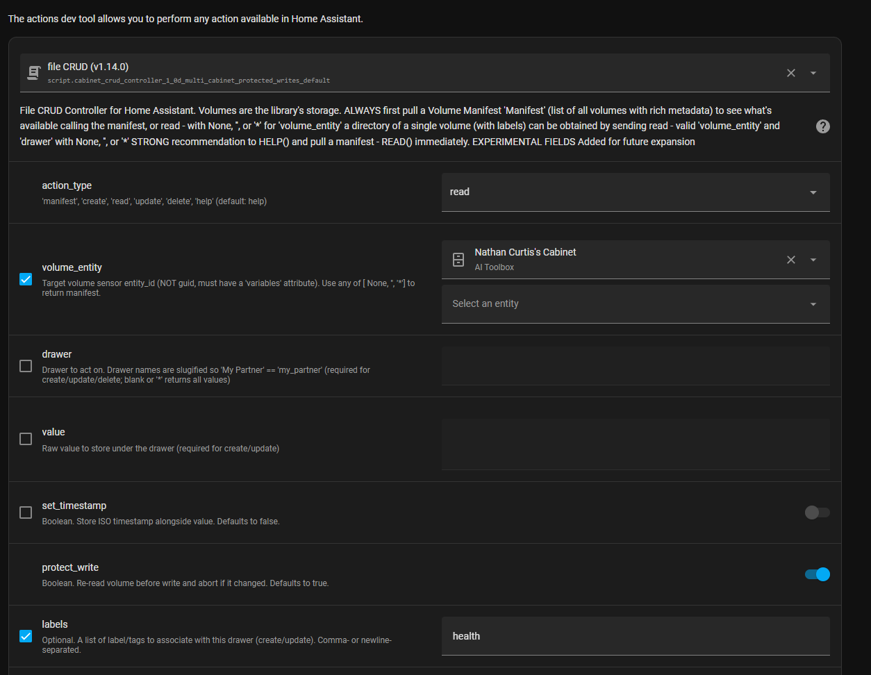

    • file_CRUD1.0.0-RC Mount a Fes-style - [Trigger based template sensor to store global variables - Community Guides - Home Assistant Community](Trigger based template sensor to store global variables and surf that son of a gun like a disk drive…
  • refactored Zen index v.2 - as script (Yes it got a name, requires file CRUD)
  • bring all v.2 CRUD tools to accept label index as target…

So way early in the thread I point at Fes’ trigger text sensor because this is the closest thing we have to text storage. It has limits as noted above but… Well through some probably ill-advised event triggers and such - we end up presenting effectively a library full of cabinets to Friday…
and any good library has a card catalog (yes im old now, whatev), we call ours a manifest.
Yes it ALSO has a name - that we can refer to. (remember the elephant - this is small context) but a strange things happen when you apply an index system to each ‘drawer’ of the ‘cabinet’ (elephant in drawer X)
This is where I got really mad that it was so difficult to CREATE a Fes style trigger text sensor and kind of thankful that it kept me from creating 86 cabinets So far I’m at 7 active sensors == volumes == cabinets and have been able to define most context appropriately (and well wierd stuff later)
Geek crap (Headers and default storage layout)
So I defined a way to read the ‘header’ of a volume (specially written key) and see what s in it - when read a certain way you get:
Then:
  1. The Household > Contains a pointer to the family cabinet, DETAILED metadata with pointers to other systems, one drawer per room.
  2. Family Cabinet > Contains a pointer to every member, owner/HoH listed in the descriptor
  3. Person Cabinet (or AI cabinet, special case person) > Contains pointer to AI assistant (multi AI system) and partner cabinet(s)
  4. The Dojo: one drawer per major system - basically Kung fu descriptors as above - plus more (I’m doin gthis because I can consolidate all info about acomponent in one place and pull-out parts by key reference… What’s the label (list) for Water Manger?
  5. The Kata Cabinet 1:1 match for Dojo cabinet - the landing place for a summary of that component. Then we fire as many small fast component level summary and inference jobs as the hardware allows and park them here. I read something in Allen’s github about a room summarizer and decided to out it on 'roid rage mode. He’s right we needed a summarizer. I personally don’t center mine on rooms but overall concepts. Rooms (room manager) is only one of those concepts.
Well - this is when we need to start thinking less like people and more like Friday - because I now give her a function that reads all of those in parallel for a label… It’s like she has X-Ray vision
Why so complicated bro?
Tie it in with an indexer - that uses the same tagging system: Friday's Party: Creating a Private, Agentic AI using Voice Assistant tools - #115 by NathanCu
And write a tool that reads by label [cabinet list] > Drawers or Drawers and content where it appears across the entire data space…
(Almost done - this one CAN break stuff)
When she has the whole manifest she can resolve those mounts.
Ahh there’s the why… Controllable context
I can now turn on and off chonks of context -and the references themselves are also contextual. You can filter the reads across the space with labels and scan the whole thing like a data lake. This is also the injection point for secure access and encrypted files if you wanted. This is where I intercept mounts and show them differently.
We then assume a certain default base set for load and:
Begets:
  • Directives Thou shall / shall nots < Loads from SYSTEM
  • Kung Fu - Same as previous now way faster and indexable < Loads from DOJO
  • Kata - The place where we store the summaries. << KATA
  • Manifest - Where the stuff lives (breadcrubs for the storage - pathing) << PROCEDURAL
  • AutoFu - Kung Fu prompts to breadcrumb the components contexts *we’ll discuss this in a nother ep. << DOJO \ AutoFu
  • Supplemental prompt (same but user version) << AI \ AutoExec
  • Essence - MD5 Hashed capsule containing the personality prompt << AI \ Essence
  • Wake - sets tone and posture for wake state (can also trap non-interactive wake and set instruction) << AI \ Essence.wake
The prompt is how a procedural template… (Well that only took 18 months… No big.)
So she now loads the whole darned prompt procedurally with a default setup and we can now change / impact behavior just by doing an index search. That index search resolves to:
  • These entities and state data
    THIS is Perception - Now / What
  • These drawers and contents
    Dump of indexed drawers yield instructions - maybe even a whole component instruction set like water_manager? :smiling_imp:
  • Tools applicable to task << list of applicable commands (pulled from the commands list under KF components which itself can also be expanded and indexed if necessary)
Sounds like everything she needs to act like an agent to me :wink:
And when you add an instruction that anything you don’t understand attempt to resolve through an index call and teach it how to can Boolean set search…
Yeahhhhh. NOW you get the weird stuff.
That Consumables system… That’s Grocy Which also has its own context drawer in the dojo.
We’re going to have to glue together about a half dozen Fez sensors and overlay a weird index system that’s probably half broken and not really working…
But, that’s why I have you guys?
FileCrud coming, a few more tests. Until then - this is why. We now have a name for every context, and a way for her to chase it.
Future Nathan Says:
Documented this in practice in the hypergraph model for ZenOS-AI here:
zenos-ai/docs/cabinets/hypergraph_model.md at main · nathan-curtis/zenos-ai
