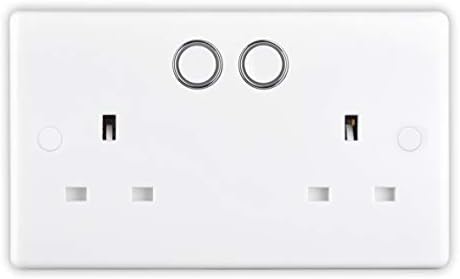

Has anyone used BG Sockets (UK)
Just checking if there’s any integration for BG Sockets
And if it can be flashed maybe with Tasmota/ESPHome and if it has a power monitoring version…

Bit of an old thread here but I bought these BG Sockets last week and tgot them working using the BroadLink app and then in HA they were found by the BroadLink integration. The only thing I had to do in the BroadLink app was unlock the device.
I would however note at time of purchase there were two models available albeit at the same price. 800 and 900. I bought the 900.
There was a firmware waiting but I got the Sockets working before the firmware so I would advise to skip the firmware initially to see how you get on, however after the firmware update I was still able use them with HA.

Hi! Just wondering how you managed to use the BroadLink App to register the socket, as I couldn’t figure it out. Any help would be appreciated. Thanks!
The BG app and the Broadlink app appear to be the same. I could not get either app to connect at first but eventually the Broadlink app connected using ‘General Wi-Fi device’ + ‘Smart set up’ mode. At the start of this mode, you need the socket led’s to be flashing really fast - press and hold the left on button for a few seconds. If they are flashing slow long press the left switch again. During the setup they change to slow flash which I think is the socket turning on its AP. It took a few minutes but got there in the end. You have to use the app to unlock the socket before adding to HA - on socket page top right, 3 dots, ‘General’ turn ‘lock device’ switch off
