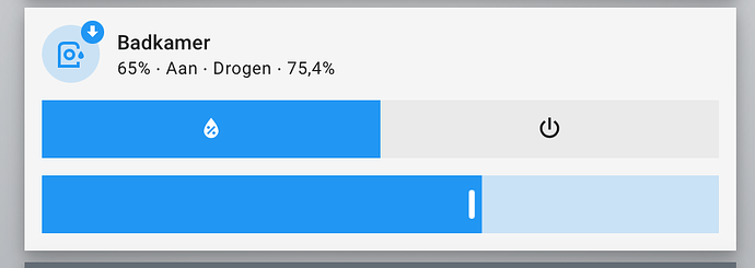

How to set border-radius on Tile card Features
separate post for clarity, and because it is unexpectedly difficult…
trying to set a border-radius of my theme to the buttons on the humidifier, I can not immediately find a way to do so:
  - type: tile
    entity: humidifier.badkamer
    card_mod:
      style:
        hui-card-features $:
          hui-humidifier-toggle-card-feature $:
            ha-control-select$: |
              .container {
                border-radius: var(--ha-card-border-radius);
              .option-on.option.selected {
                --control-select-button-border-radius: 0 !important;
          hui-target-humidity-card-feature $:
            ha-control-slider$: |
              .container {
                --control-slider-border-radius: var(--ha-card-border-radius);
              .slider .slider-track-bar {
                border-radius: var(--ha-card-border-radius) !important;
works almost perfectly, except for the option buttons
if I set the border-radius on the element in Inspector, it does kick in, but somehow my card-mod skills leave me here.
and upon reloading even the container fall back to its default 10px now… so not reliable after all
I did manage to pull it off on several other tiles
carefully watching my Climate tile, I can copy this:

and bingo:
Ive found card_mods for the type: tile cards on the domains I use, and list them below so hopefully someone can use them. I’ve left some commented code I dont use, but which can be set if you might wish so. I might still give it a go to set the border-radius on the small track-bar handles inside

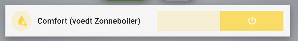

modding that toggle can be done with
# tile_toggle
card_mod:
  style:
      hui-card-feature $:
        hui-toggle-card-feature $:
          ha-control-switch$: |
            .switch {
            .button {
              --control-switch-border-radius: var(--ha-card-border-radius);
              opacity: 0.8;
and results in:

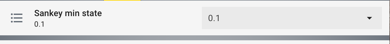

added a mod for the input_select entities:
# tile_input_select
style:
    hui-card-feature $:
      hui-select-options-card-feature $:
        ha-control-select-menu $: |
          .select .select-anchor {
          mwc-menu {
            --mdc-shape-medium: var(--ha-card-border-radius) !important;

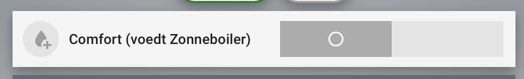

found a few sweet modifications for a counter in a tile (as always, ha-card-border-radius is set in my main theme)
          - type: tile
            entity: counter.warnings
            <<: &features
              features_position: inline
              features:
                - type: counter-actions
                  actions:
                    - reset
              hold_action:
                action: navigate
                navigation_path: /config/logs
            card_mod:
              style:
                  hui-card-feature $:
                    hui-counter-actions-card-feature $:
                        ha-control-button $: |
                          {% set warning = states(config.entity)|float(-5) > 0 %}
                          .button {
                            --control-button-border-radius: var(--ha-card-border-radius);
                            --control-button-icon-color: {{'green' if not warning}};
                            opacity: 0.8 !important;
                            background: {{'var(--warning-color)' if warning}} !important;
                  ha-tile-icon {
                    --tile-color:
                      {{'var(--warning-color)' if warning else 'var(--success-color)'}};
