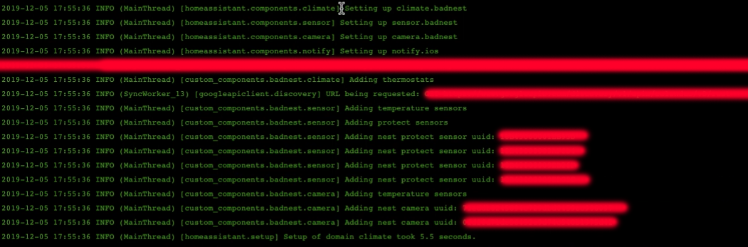

My instance started giving errors as well but I updated the issue_token and cookie (ran through the process again) and it came back, minus the thermostat which is still not being detected.
When starting up, it sets up all the badnest items (climate, sensors, cameras etc) but when adding nothing appears under Thermostat but you can see that the Protect and Cameras are being added.
