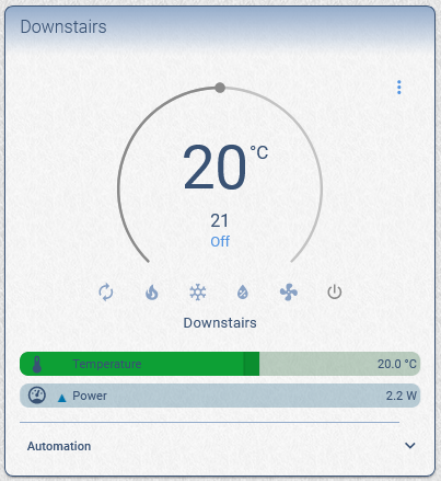

Here’s mine:
The reason for the bar graph temperature is that the temperature reported on the thermostat is the system temperature, not the room temperature. They just happen to be the same at the moment. Usually they’re not, like this (you can also see how the bottom section expands to reveal the settings. It uses fold entity row):

Exactly what i wanted. Idea with the collapsible automations i what i was looking for! Thanks!
Really neat styling of the dashboard. Do you have a descriton of it somewhere?

tom_l:
For this one. Is it a vertical stack? Thermostat + two bar cards and then a foldable one?
I’m guessing stack-in-card
tom_l
February 12, 2022, 8:52am
9
It’s actually an entities card. Using this:
Funny thing about lovelace - cards, rows in the entities card, badges and elements in the picture-elements card work exactly the same behind the scenes.
That means that you can use them interchangeably if you know how, and e.g. put a button right in an entities card, a badge somewhere in the middle of your view or a markdown card (with background and border removed) right in your carefully crafted picture-elements card. Pretty neat stuff that allows for some fantastic creations.

Thanks once again.
Using your ideas i came to a dream solution
Vertical stack per floor. Then use the entity:row plus folding
