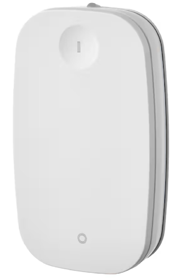

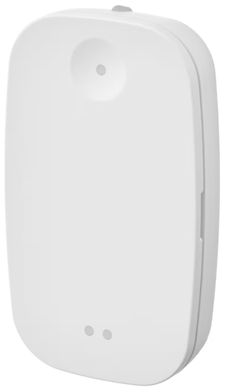

This blueprint will allow you to control a light via ZHA or Zigbee2MQTT with either:
Bilresa (2 buttons variation)
Rodret
Somrig
Tradfri (on/off)
