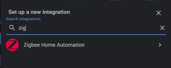

#7 Go to Configuration, Integrations, hit the Plus to add a new integration. Select Zigbee Home Automation .
Choose “Enter Manually” and hit Submit.
Radio Type is EZSP
Enter socket://:8888 and use 115200 for the port speed. Hit submit.
Give it a few seconds to query the device and you should see the following screen.
Congratulations! You did it! Hit Finish. You should now have a Zigbee integration in Home Assistant. Click Configure.
*Hit the Plus and start pairing your various Zigbee devices. *
You are all done! Add all your various Zigbee device types and enjoy!

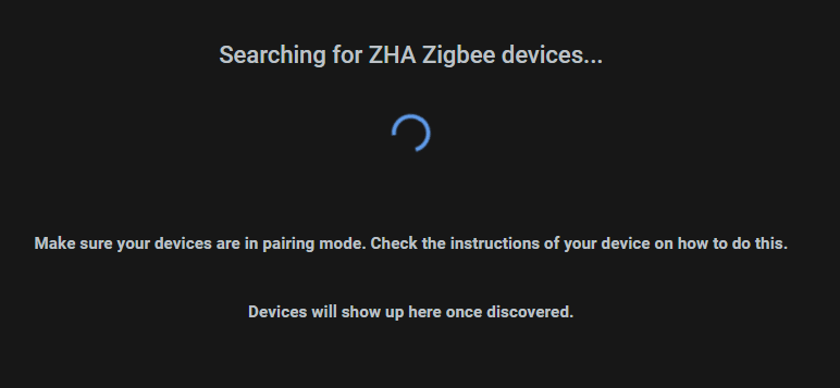

I have added the coordinator successful like NK553 and Ronald stoop. but cant seem te get a device paired. Has anybody had any luck with this?
I have tried to following without succes:
Upgraded the firmware https://github.com/xsp1989/zigbeeFirmware/tree/master/firmware/Zigbee3.0_Dongle
Used ncp-uart-nsw_679_115200.gbl and ncp-uart-sw_679_115200.gbl (does anyone know the difference between these, accept for the filesize??).
Still cannot pair devices…
Tried using it on a Python venv Home Assistant on Windows… ZHA integration installs but still cannot pair devices… (to test if bare-metal works).
Also tested on ESXi and VMware Workstation. Integration works but no pairing.
