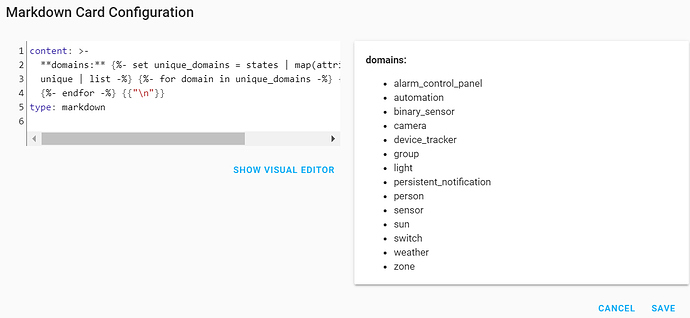

I display that as a ‘System Info’ in ‘card’.
The only question I have - how to place both lists in horizontal view, not vertical?
As it is now on the screen…

This is ‘markdown’ + ‘script editor’:
