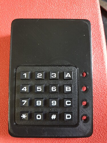

Here is my attempt :slight_smile: works as I want it to, written a little controller software for the esp32, communicates with HASS by MQTT and that’s it :slight_smile: HASS verifies the alarm codes, this is simply a controller. Works with the Alarmo integration perfectly!

My print arrived for the other version but it wasn’t great and now all the pins have snapped off :slight_smile:

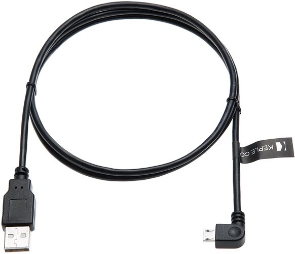

This new version should allow for the esp32 to sit above the usb socket (I hope) - on UK amazon I’m using these:
And this was the smallest right angle cable I could find pointing the right way which I’ve now chopped and attached a dupont connector to:

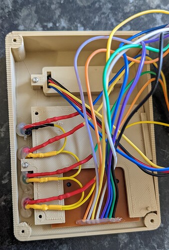

Should have the next versions printed in a couple days but here’s pics of how these ended up
