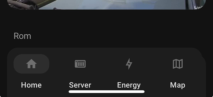

815
Thanks, now its fixed but i cant seem to get the width right here is a before and after picture.
How can i get the width and bottom padding right?
Before:
After

Test this out and let me know…

The code in the solution has the necessary fields under ha-card {, not host:
Test this out
