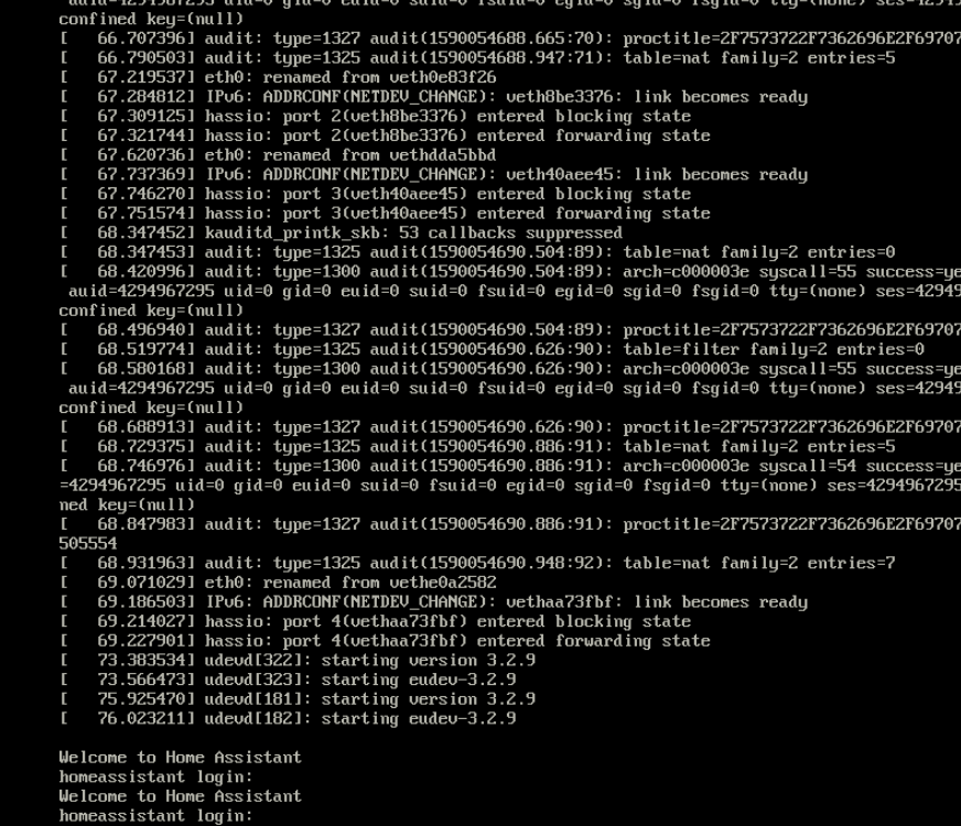

[UPDATE]
I have managed to get it working with downloaded virtual appliance .vdi file.
https://www.home-assistant.io/hassio/installation/
In VirtualBox (I used version 5.2.42):
  1. Add Disk Image File (File > Virtual Media Manager > Add), select downloaded .vdi
  2. New Machine:
  • Name: hassio
  • Type: Other (Important)
  • Version: Other/Unkown 64-bit (Important)
  • Memory: 1024MB
  • Hard disk: select added hassio vdi
  1. No need to start
  2. In created machine settings:
  • System:
    • Uncheck Floppy, Optical
    • Select Chipset: ICH9 (Important)
    • Extended Feature: check APIC, EFI, Hardware Clock (Important)
  1. Others not quite important
  2. Export Machine to .ova (Machine > Export to OCI):
  • Select Format: Open Virtualisation Format 1.0
  • Enter file name and path
  • Continue
  1. done
In QNAP Virtualisation Station:
  1. Import VM
  • Import From: PC
  • Select created .ova file
  1. Enter Info by your desired
  2. Advanced Settings:
  • CPU: i7
  • Netwrok: Intel Gigabit Ethernat
  • Hard Disk:
    • Cache Mode: Writeback
    • Controller: IDE
  1. Import
  2. Done
