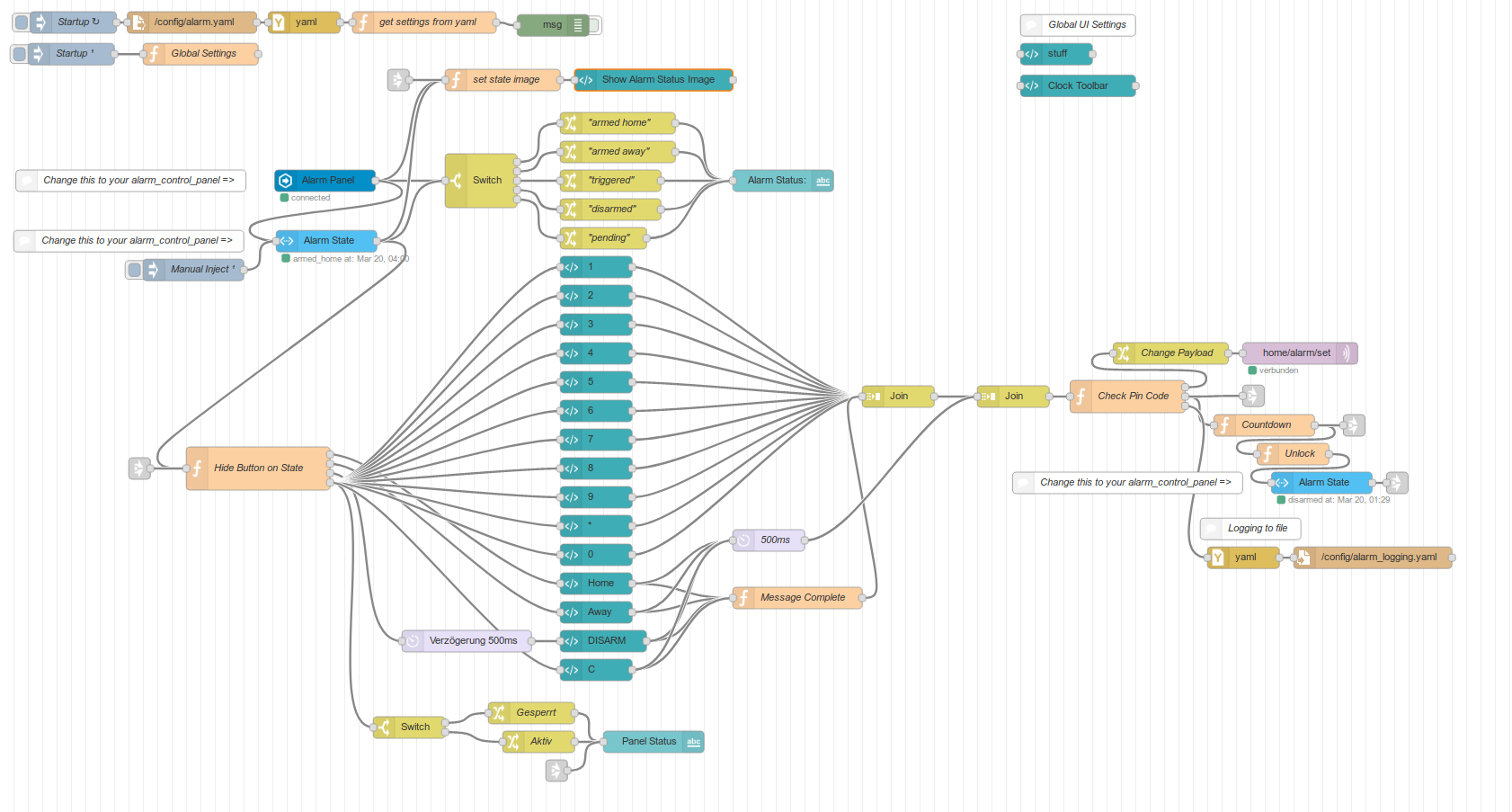

Here is a Screenshot of the flow:
The most components are in Node RED included, but you will need to install node-red-dashboard.
After the import you must edit the following nodes for your install:
Home Assistant: AlarmPanel and Alam State
MQTT: home/alarm/set
Function: Global settings
If you have all configured, you can browse to your node-red install
https://:1880/ui/#!/0 -> there you will find the dashboard.

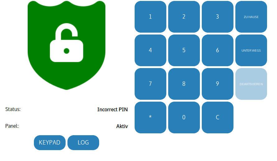

somthing like this?
the wrong pin state change back to original state after 8 seconds …
