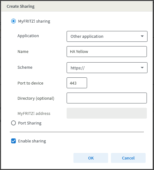

Renewal isn’t automated, yet (much stuff happening all around, can’t get my hands at completing the HA cert workflow in the next couple of days/weeks), but for the initial cert issue, I made sure I chose MyFritz sharing instead of Port sharing:
This way, you get the nice “bonus” of using, e.g., https://yellow.[random].myfritz.net instead of https://[random].myfritz.net.

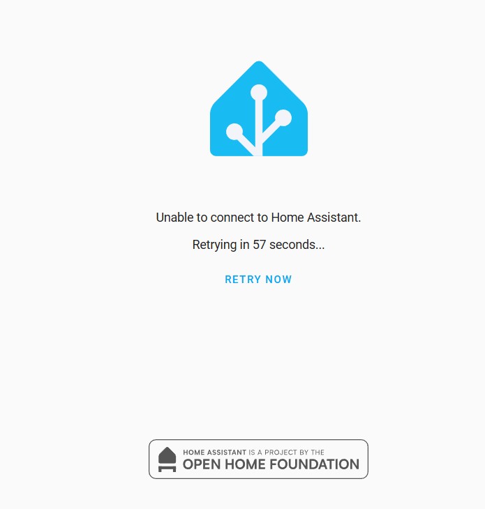

I can remote access my FritzBox through the xxxx.myfritz.net address. When I try to access HA on xxxx.myfritz.net:8123 it refuses to connect:
So xxxx.myfritz.net resolves, then why the error from Let’s Encrypt?

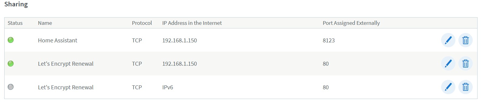

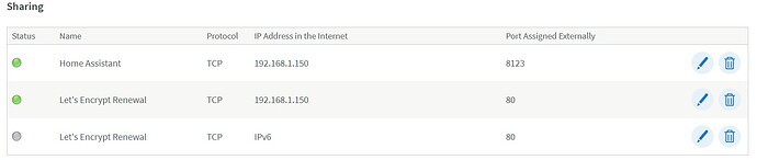

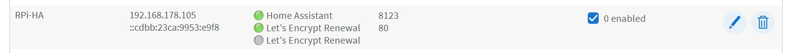

Thank you. Yes port 80 is forwarded:
and
This problem has been going on for months. Somewhere in that timeframe I changed to a new (temporary) provider. Using Odido (Netherlands) on the 4G network, and connect the FRITZ!Box to the internet through the Odidi WiFi.
Poor setup (although it works fine for everything else including streaming), but I have to live with that until I move again. Does the setup somehow block getting the certificate?
I noticed that the FRITZ!Box is also unable to get a Let’s Encrypt certificate (it hangs after requesting one), so I use the self issued and registered that for now.
That might cause issues because some protocols might be blocked.
Also I noticed that your external fritzbox IP is 192.168.1.150. This is strange since 192.168.1.x is reserved for internal networks. And this might also be an issue here.
