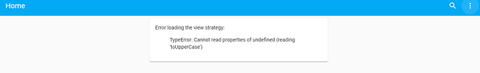

I fell over on this little hurdle (my own fault). I followed the steps to Raw mode > Select All > Delete.
Now I have:
If I now go Edit Dashboard (the only option available), I get this:
So I am looking for a bit of guidance; do I choose ‘Start with an empty dashboard’ or ‘Take Control’ or both?
Looking to get an autogenerated dashboard.
Please help if you can.
Thanks.
EDIT; Fixed. I had some devices named the same as the areas they were in. Renamed those devices and success!
