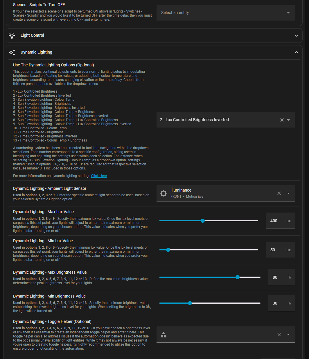

Hey All,
I’m sure this has been covered, but the thread is so long now, so apologies if I’m repeating.
I’m trying to do a pretty standard set up using dynamic lighting, but I cant seem to figure out what section in dynamic lighting you select the actual light to dim?
Where is this?
Just for full scope,
I have a set of outside strip lights, 3 sets in total.
2 of the sets are on a simple ON/OFF Zwave plug, and 1 set is on a Fibaro RGBW controller (NOTE: All strips are warm white, so I do not use the RGB channels)
I want all the LED strips to turn on at a certain LUX value (Lets call is 400), but I want the RGBW controller to then be brightness controlled depending on Lux value of an Aeotec Multi Sensor.
Then in the morning once the Lux goes above 400, they all turn off.
NOTE: I also want these to action if its day time but over cast, so hence reason of using Lux rather than sunset/sunrise.
So,
Lux <400
Then
Turn on Fibaro RGBW (LED strip 3) at 85% brightness AND TP Link P110 Plug (LED Strips 1 & 2)
Then also Fibaro RGBW brightness to between 85% and 30% depending on Lux value (down to 0 Lux)
If Lux >400, turn all off
Many thanks for your help in advance
Russ

@rustyh
Lets break it down.
Turn the light ON when the value drops below 400, and OFF when it rises above 500. It’s a good idea to keep a buffer between ON and OFF so your lights don’t flicker. These numbers are just examples — you might prefer OFF at 450, 550, or even 600. It’s up to you. You can set this up with my :high_brightness: Smart Light blueprint using Trigger - Ambient for this.
Once the light is ON, you also want to control its brightness. For that, set up Dynamic Lighting (option 1 or 2, depending on your needs). Note that Dynamic Lighting only works with entities in the light domain, not switches. The light must support brightness adjustment. If you can adjust it in the Home Assistant UI, then the automation will be able to adjust it too.
Blacky :grinning:

Thanks for the reply Blacky,
I gave it ago per the below images, but the lights didnt turn on?
Any idea whats going wrong?
@rustyh
Your using a device in Lights - Switches - Scenes - Scripts and you can only us entities. See this FAQ click here
Blacky :grinning:

Thanks Blacky,
Ive changed this as below, but its still does not seem to be working

@rustyh
:thinking: White channel.
Are you using the correct entity? Can you adjust the brightness of this entity? Is this a Shelly and been set up correctly.
Blacky :grinning:
