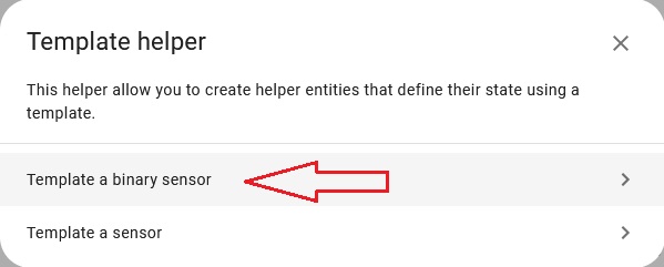

I’m new to this blueprint, but have been experimenting. I love the flexibility and capabilities. I am particularly interested in the tracker option, but I think it does the opposite of what I want. My use case:
I want to do some alarm type functions - and they should only trigger if my wife and I are NOT home.
I have about 6 app carrying users on my system. Two of us live in the home and the others may be visitors. I have an outdoor yolink motion sensor. When that motion sensor triggers, I want to turn on a number of lights that would illuminate the backyard, and then turn them off a few minutes after the motion sensor clears. All good so far.
My issue is that, I only want it to trigger when two of the users (myself and my wife) are NOT present. (ie not in the “home” zone). So it could be triggered by one of the other users or by a stranger. I believe your blueprint is designed to do tracker triggering only if certain people ARE present - not if a specific set of people are NOT present.
What is the best way to accomplish this? Should I try and build a template for a bypass switch that is active when the two of us are away - or am I missing a simpler way of doing this?
I have multiple zones, so I cannot just test for the two people being in the “away” zone.
Thanks for all your work on this!
@kenwiens
Yes. I have added a new template for you into the FAQ Click Here and look for “REF - TS-8 By-pass Person Sensor”.
Home assistant have a new template helper now that makes it easy for us to add and edit. So you could do this. Go to settings / devices and services / helpers tab / create helper then follow below.
  1. Click template
  2. Click binary sensor
    2
  3. Add your name, state & device class. The click “Submit”
# The code for the state
#For one phone
{{ is_state('device_tracker.your_phone_here', 'home') }}
# Or for more than one phone
{{ (is_state('device_tracker.your_phone_here', 'home')) or (is_state('device_tracker.your_phone_here', 'home')) }}
  1. Enter it into the by-pass
Hope this helps you
 let us know how you go.
Blacky :smiley:
