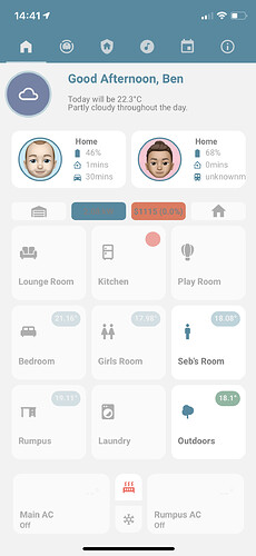

Rather than showing off specific elements, buttons etc, thought it would be good for people to share their entire screens/dashboards. I’ll go first to get the ball rolling, still work in progress on these though!

the one showing the vacuum? Also how did you get the “Good Morning Ben” with the weather forecast display? looks cool.

A few steps to create the greeting (stole it from someone else here of course!):
  1. Create an Input Select:
    frontend_greeting:
        options:
          - Good Morning
          - Good Afternoon
          - Good Evening
          - Good Night
  1. Create automations to set the state at different times. This checks every 5mins and updates, you could probably set it to trigger at the specific times to save CPU though:
- alias: Frontend Greeting
  trigger:
  - platform: time_pattern
    minutes: /5
  - platform: homeassistant
    event: start
  action:
    service: input_select.select_option
    data_template:
      entity_id: input_select.frontend_greeting
      option: "{% if (states.sensor.time.state > '22:00') and (states.sensor.time.state\
        \ < '06:00') %}\n  Good Night\n{% elif (states.sensor.time.state > '06:00')\
        \ and (states.sensor.time.state < '12:00') %}\n  Good Morning\n{% elif (states.sensor.time.state\
        \ > '12:00') and (states.sensor.time.state < '18:00') %}\n  Good Afternoon\n\
        {% elif (states.sensor.time.state > '18:00') and (states.sensor.time.state\
        \ < '21:59') %}\n  Good Evening\n{% endif %}\n"
  1. Use markdowns to display:
              - type: vertical-stack
#                view_layout:
#                  grid-area: header
                flex-grow: 2
                style: |
                  ha-card {
                    box-shadow: none;
                    border-style: hidden;
                    border-bottom-right-radius: 0px;
                    border-bottom-left-radius: 0px;
                cards:
                - type: markdown
                  style:
                      ha-card {
                         background-color: rgba(0,0,0,0) !important;
                         box-shadow: none;
                    ha-markdown:
                        ha-markdown-element:first-of-type h2 {
                          background-color: rgba(0,0,0,0);
                          color: var(--primary-color);
                          font-size: 18px;
                          line-height: 18px;
                        ha-markdown-element:first-of-type h3 {
                          font-weight: normal;
                          color: var(--primary-text-color);
                          font-size: 12px;
                          line-height: 12px;
                        ha-markdown-element:second-of-type h3 {
                          font-size: 12px;
                          line-height: 12px;
                  content: |
                      ## {{ states('input_select.frontend_greeting') }}, {{user}}
                      ### Today will be {{ states('sensor.dark_sky_daytime_high_temperature_1d') }}°C <br/> {{ states('sensor.dark_sky_summary_1d') }}

Just a range of different custom button cards with custom fields depending on my needs eg. temperature only, temperature + colour code for certain appliances/devices.
I use popup cards through card-mod to show everything within that room.
