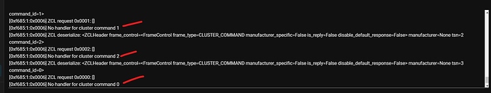

this is my log went i log de devices :
command 2 double clic
command 1 for clic
command 0 for long press
If you or somebody else have solution it will be great after 3 day of research

I also have this issue. I have:
  • SNZB-03 (motion sensor)
  • SNZB-02 (temperature sensor)
  • SNZB-04 (door sensor)
and they all work fine but…
the SNZB-01 (wireless switch) was easy to add to my Zigbee integration, but does not show the button state, only the battery state.
That’s normal ‘danielmurtagh’.
For reasons I don’t understand, an entity is not created as such for the motion sensor. To use the sensor you need to monitor the event bus for a zha-event produced by the button.
Here’s a Node-RED flow that I created to test a button:
[{"id":"be4429a7.7b2b3","type":"tab","label":"Flow 4","disabled":false,"info":""},{"id":"3a6725d4.62d622","type":"switch","z":"be4429a7.7b2b3","name":"","property":"payload.event.command","propertyType":"msg","rules":[{"t":"eq","v":"toggle","vt":"str"},{"t":"eq","v":"on","vt":"str"},{"t":"eq","v":"off","vt":"str"}],"checkall":"true","repair":false,"outputs":3,"x":270,"y":300,"wires":[["85ee1c58.53547"],["61570751.41b5d"],["3a5eeed8.15850a"]]},{"id":"46fd050.9989afc","type":"server-events","z":"be4429a7.7b2b3","name":"Button","server":"93de20d5.59f72","event_type":"zha_event","exposeToHomeAssistant":false,"haConfig":[{"property":"name","value":""},{"property":"icon","value":""}],"x":70,"y":200,"wires":[["4c499f2f.00b788"]]},{"id":"61570751.41b5d","type":"api-call-service","z":"be4429a7.7b2b3","name":"Effect 2","server":"93de20d5.59f72","version":1,"debugenabled":false,"service_domain":"light","service":"turn_on","entityId":"light.lohas_bulb2","data":"{\"effect\":4,\"profile\":\"relax\"}","dataType":"json","mergecontext":"","output_location":"","output_location_type":"none","mustacheAltTags":false,"x":480,"y":300,"wires":[[]]},{"id":"85ee1c58.53547","type":"api-call-service","z":"be4429a7.7b2b3","name":"Red","server":"93de20d5.59f72","version":1,"debugenabled":false,"service_domain":"light","service":"turn_on","entityId":"light.lohas_bulb2","data":"{\"color_name\": \"red\"}","dataType":"json","mergecontext":"","output_location":"","output_location_type":"none","mustacheAltTags":false,"x":470,"y":220,"wires":[[]]},{"id":"3a5eeed8.15850a","type":"api-call-service","z":"be4429a7.7b2b3","name":"Off","server":"93de20d5.59f72","version":1,"debugenabled":false,"service_domain":"light","service":"turn_off","entityId":"light.lohas_bulb2","data":"","dataType":"json","mergecontext":"","output_location":"","output_location_type":"none","mustacheAltTags":false,"x":470,"y":380,"wires":[[]]},{"id":"4c499f2f.00b788","type":"switch","z":"be4429a7.7b2b3","name":"Button 2","property":"payload.event.unique_id","propertyType":"msg","rules":[{"t":"eq","v":"00:12:4b:00:1c:d6:10:45:1:0x0006","vt":"str"}],"checkall":"true","repair":false,"outputs":1,"x":120,"y":300,"wires":[["3a6725d4.62d622"]]},{"id":"93de20d5.59f72","type":"server","z":"","name":"Home Assistant","legacy":false,"addon":true,"rejectUnauthorizedCerts":true,"ha_boolean":"y|yes|true|on|home|open","connectionDelay":false,"cacheJson":true}]
(I thoroughly recommend that you use node-red. I find it far easier to use than YAML, with its paranoid indentation!)
Jim
Yes after a bit of research it is as Jim says. There is no entity.
The reason (I think) it is not an entity is that it has no defined state ie there is nothing “set” on the switch. It is a momentary press (or long press) which generates an event. You can do whatever you want with that event to trigger actions that change the state of other entities. After you release the switch though the SNZB-01 is not in any different state to what it was before. I think that is why it is not an entity. Here is how to use it in HA:

Hi @jimford and @pgv
Thanks very much for that information, it totally makes sense and I have now set up an event bus monitor and triggers based on Jim’s example and its working perfectly for my 8x sonoff zigbee switches!
Thanks for taking the time to share your knowledge.
