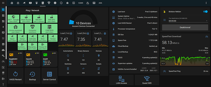

what do you use to get the CPU temp and load of a remote computer?

For Windows im using the Open Hardware Monitor integration:
For Linux im using Glances:
https://nicolargo.github.io/glances/
