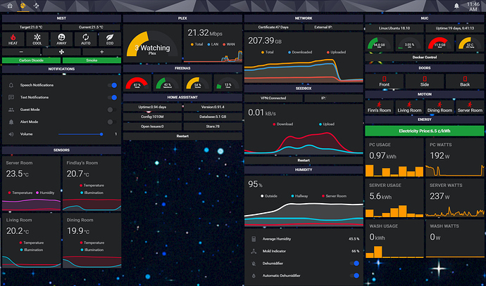

What would you like to see, the card configuration or the sensor config?
  - platform: command_line
    command: "cat /sys/class/thermal/thermal_zone2/temp"
    unit_of_measurement: "°C"
    value_template: '{{ value | multiply(0.001) | round(0) }}'

Would love to see your config for the graphs which show multiple entries (eg. downloads and uploads in one graph). Really like the way you have laid it out!
Here’s an example with 2 graphs
  - accuracy: 5
    align_icon: left
      - entity: sensor.pi_hole_ads_blocked_today
        show_state: true
        unit: ads
      - entity: sensor.pi_hole_dns_queries_today
        show_state: true
        unit: queries
    hours_to_show: 168
    icon: 'mdi:pi-hole'
    line_color: '#0073D4'
    points_per_hour: 0.05
    show:
      points: false
    type: 'custom:mini-graph-card'
I updated it based on some others here

Here it is:
card:
  color: white
    - cards:
        - cards:
            - card:
                animate: true
                  - sensor.cpu_temp
                graph: line
                name: CPU hőmérséklet
                show:
                  icon: false
                  extrema: true
                hour24: true
              style:
                background-color: 'rgba(0,0,20,0.3)'
                background-size: 100% 100%
                border: 'solid 1px rgba(57,128,228,0.4)'
                border-radius: 20px
                transform: scale(0.95)
              type: 'custom:card-modder'
            - card:
                animate: true
                  - sensor.processor_use
                graph: line
                line_color: 'rgba(57,128,228)'
                hour24: true
                hours_to_show: 24
                show:
                  icon: false
                  extrema: true
              style:
                background-repeat: no-repeat
                border-radius: 20px
          type: horizontal-stack
      type: 'custom:vertical-stack-in-card'
    - cards:
        - cards:
            - card_style:
                background: 'rgba(0,0,20,.5)'
                border-radius: 12px
              color: '#FFA50090'
                - sensor.cpu_temp
              max: 8000
              title: CPU hőmérséklet
              title_position: inside
              title_style:
                font-size: 12px
              type: 'custom:bar-card'
            - card_style:
                border-radius: 12px
              color: 'rgba(57,128,228,0.6)'
              max: 8000
              title: CPU használat
              title_style:
                font-size: 12px
    - cards:
        - cards:
            - card_style:
                border-radius: 12px
              color: '#FFA50090'
                - sensor.memory_use
              max: 8000
              title: használt memória
              title_position: left
    - cards:
        - cards:
            - card_style:
                border-radius: 12px
                - sensor.memory_free
              max: 8000
              title: szabad memória
    - cards:
        - cards:
            - card_style:
                border-radius: 12px
              color: '#FFA50090'
                - sensor.disk_use_percent_home
              max: 8000
              title: foglalt terület
    - cards:
        - cards:
            - card_style:
                border-radius: 12px
                - sensor.hass_db_meret
              max: 500
              title: adatbázis mérete
  show_header_toggle: false
  title: NUC/Hassio
  type: entities
style:
  background-color: 'rgba(0,0,20,0.6)'
  background-image: url("/local/pictures/cardback.png")
  border-radius: 20px
