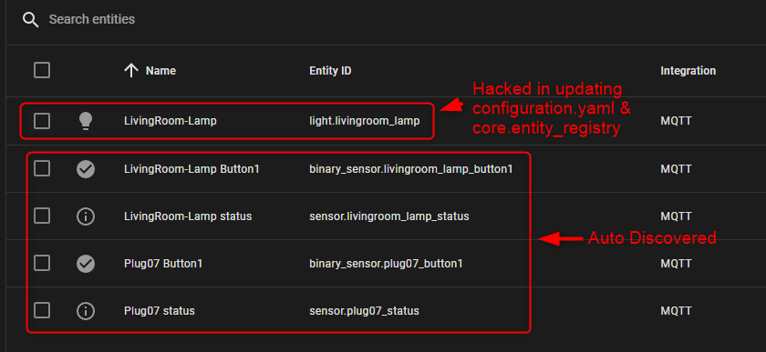

Here’s my Tasmota Integration for HA. I have my topic start with homeassistant (as that’s the default path in the MQTT discovery prefix as shown in my last post) and the sensor and binary_sensors showed up automatically via Auto Discovery (also see below)
Out of desperation, I hacked in the light.livingroom_lamp by updating configuration.yaml & core.entity_registry. It almost works, clicking on the “on” and “off” buttons sets POWER = ON (or OFF), just like the tasmota GUI does, but it doesn’t end up in a RESULT = {“POWER”:“ON”} (or OFF), i.e. there is a disconnect somewhere to a message isn’t being sent. Note that the D0524A_LI_1 matches up with the unique_id in the core.entity_registry. The device_id keeps getting reset to null which is probably what it doesn’t work as expected
Configuration.yaml

I have a few items posting to MQTT HomeAssistant topic but none of them are lights so so don’t have anything to compare.
But going back to my other point, have you not considered adding the Tasmota integration to HA rather than trying to match the HA MQTT topics? Might be an easy win in terms of matching up the sensor / light / switch types?
Ugh, I was a bit confused by Tasmota Integration, In misread it and though it said to SetOption19 1 so I dismissed it. Once In installed it and restarted my new Tasmota 12.2.0 devices, they showed up!

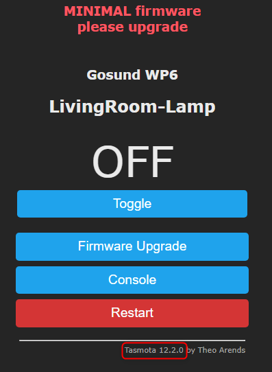

Thanks @HasQT, I used the upgrade path you posted but I guess because I started with the minimal, eventhough I used the exact links mentioned in the upgrade path and am now on 12.2.0, it still shows as “MINIMAL firmware please upgrade”
Ugh! The same thing happened when I upgraded my other plug that started at 8.1.0.2 then followed the upgrade path but ended up somehow with the “MINIMAL firmware please upgrade” on that one too. I think it I noticed all the way up to 9.1.0 was NOT minimal, not sure how the v12.2.0 somehow became minimal?
Unless you are compiling your own firmware you always need to use minimal first. That 12.2.0 one you should be able to flash the full firmware now
