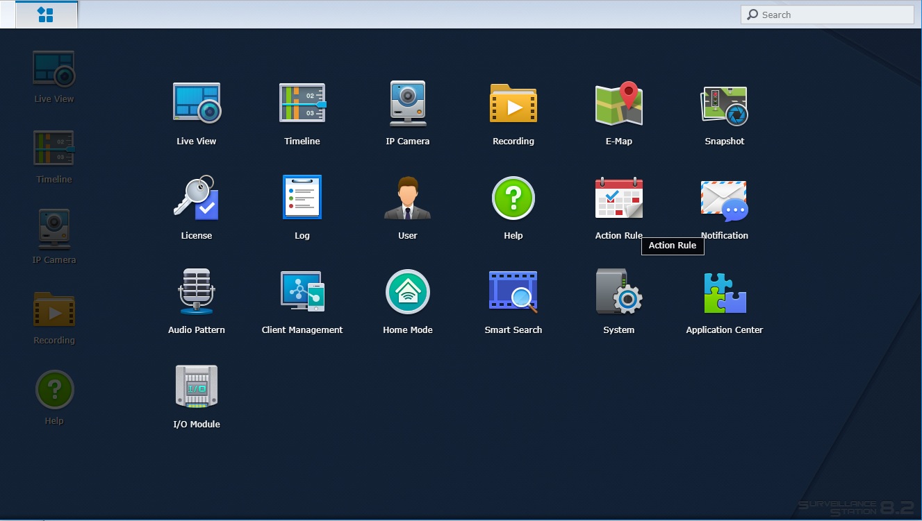

First Step is to create an Action Rule
Click on Add first.

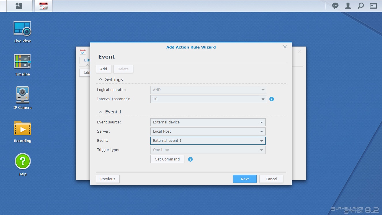

You will want to give it a Name, select triggered and decide if you want the recording Interruptible or not.
Select “External device” under “Event Source” You can have up to 10 External Events.

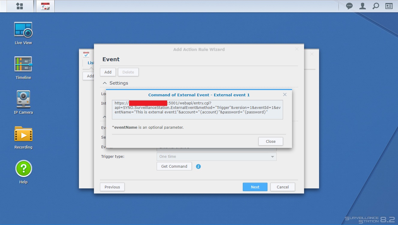

Then click on “Get Command”
Copy and paste the block of code somewhere safe for now such as a text editor. You will need to change {account} and {password} to your username and password details.

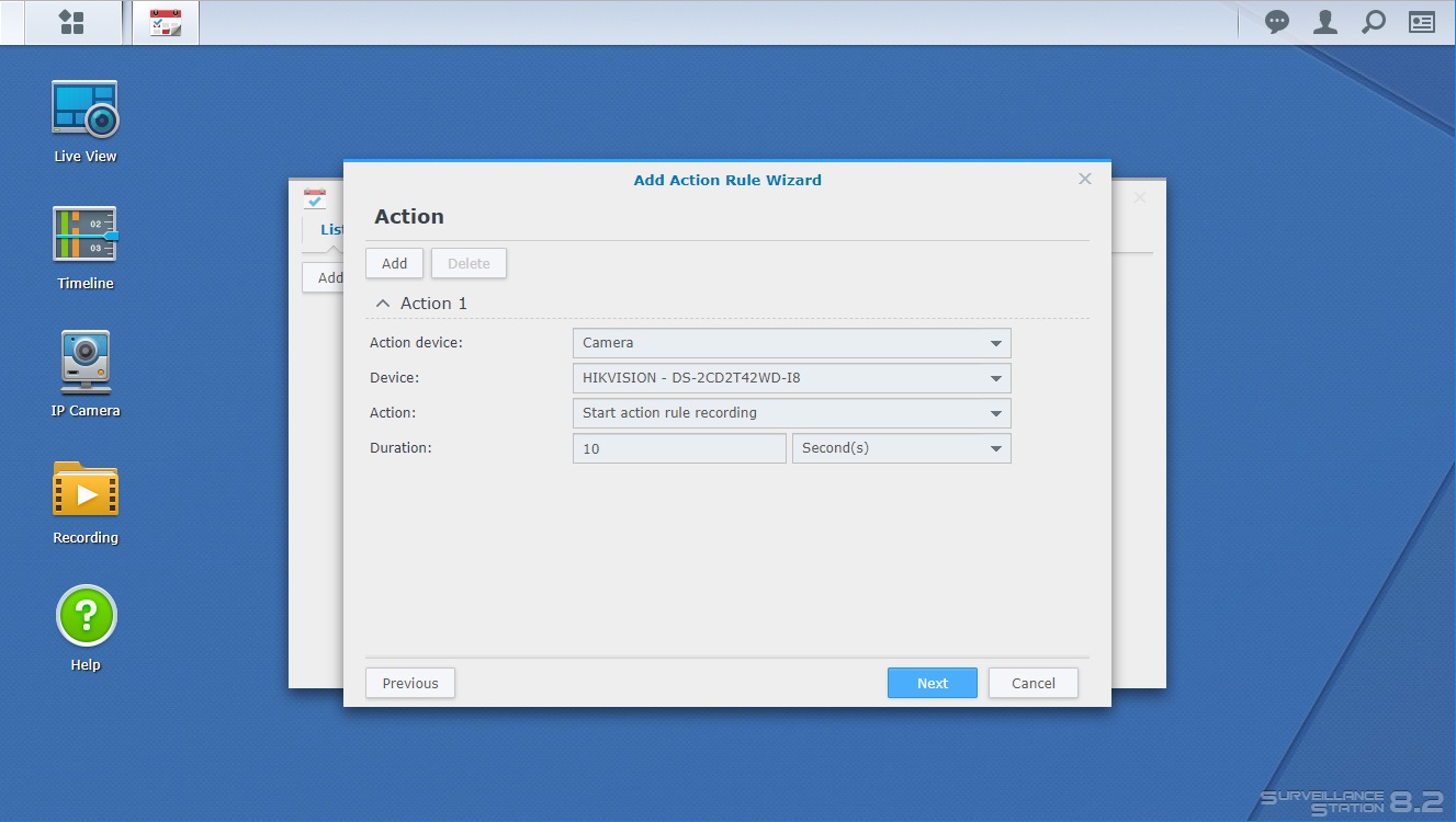

Select which Camera you want to record, select “Start action rule recording” under “Action” and select how long you want to record for when triggered under “Duration”
On the next page select the trigger schedule. I left it at the default 24/7. But you could select during the night or when you are at work etc.

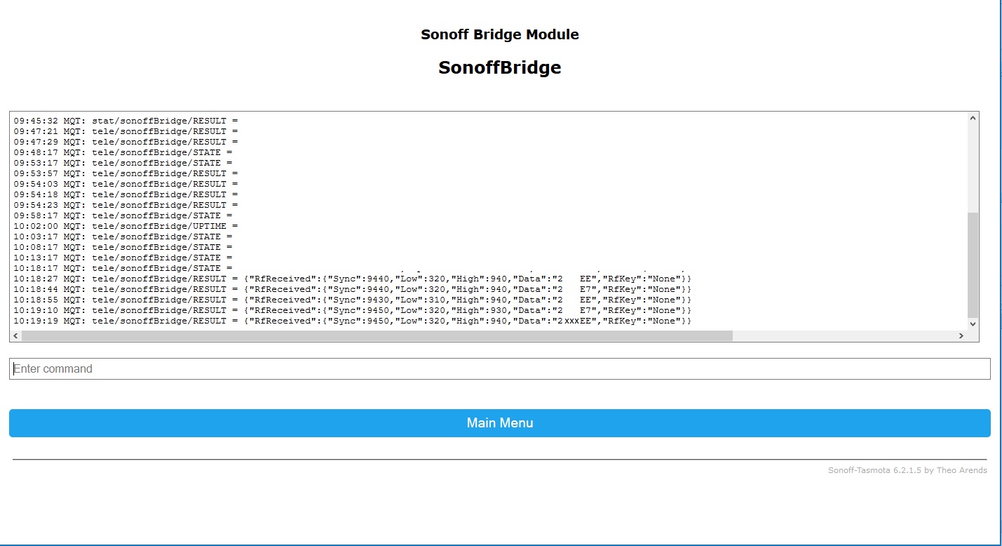

Next step is to log into your SonoffRF Bridge with Tasmota Firmware installed and go to the console page.
You want to look for the Data it gives for when the door / window is open.
In my case the Data ending EE is for the device open and E7 is for when it’s closed.
On this Kerui D026 there is also a third code ending EB stating it’s being tampered with (removed from the object it’s attached to) Note the full Data Code down for open ie 2xxxEE.
