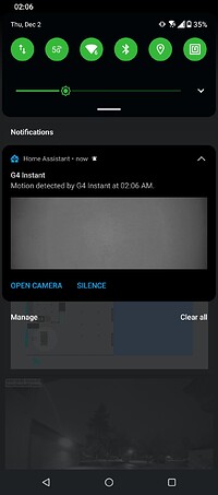

Receive notifications when motion or a smart detection event is trigger by one of your UniFi Protect cameras
Includes a thumbnail of the event from UniFi Protect
If you are using iOS, you can instead stream the camera directly to your device
Will automatically update the notification with a video clip of the event after it completes.

Regarding the Doorbell notification for Companion App (Android), is there anything special to be done to get the camera image directly in the notification like in the screenshots?
Read the requirements in the blueprint. You have to configure a base image URL (should be your external URL or Nabu Casu URL). It must have a valid HTTPS cert and must be publicaly accessible from outside of your network. Blueprint gives details on specific paths.
This is a hard requirement since Apple/Google actually fetch the URLs for the images before sending them to your phone. Your phone does not hit the URLs directly.
