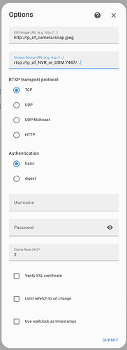

With how fickle the integration is, I ended up just adding Generic Cameras pointing at the RTSP and snapshot links. Yes, I lose the person / motion detection, but I don’t end up with random crashes of the integration and it seems to load the snapshots more quickly (and more often).
Once the integration is operational again, I’ll probably keep the Generic Camera one as the primary for images and just use the motion / person detection from the integration.
Do you mind sharing an example of your configuration using Generic Cameras ?

Your second one is closest – but the RTSP link needs to be pulled from the Camera Settings page in Protect, with changes to the port and protocol.
the snap.jpeg only comes from the camera, and the rtsp only comes from the protect appliance (and seems to be anonymous). I’ve attached what I configured in the UI.
Appreciate. How do u get this options UI ?And I see you have Basic Authentication defined, username\pwd is for a specific user within the UnifiProtect ? or your kept without anything ?

I added the “Generic Camera” integration through Settings → Devices & Services → Integrations. Then, after selecting the integration, I clicked “Add Entry” at the bottom.
It says “Basic Authentication” but the u/p info is blank. Those were defaults that I tried first and they worked.
