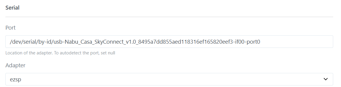

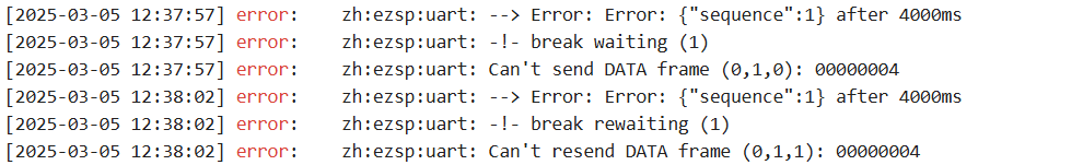

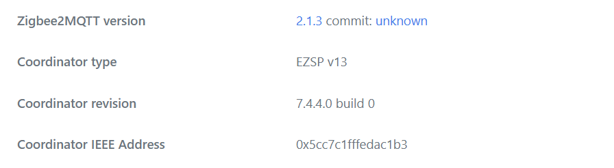

I simply can not get this to work!?
I have updated the firmware on my skyconnect.
Setting the adapter i Z2M doesn’t seem too do anything.
I can save the adapter value in the config (to ember) (the value does not change if I reboot) but it still says ezsp in Z2M
