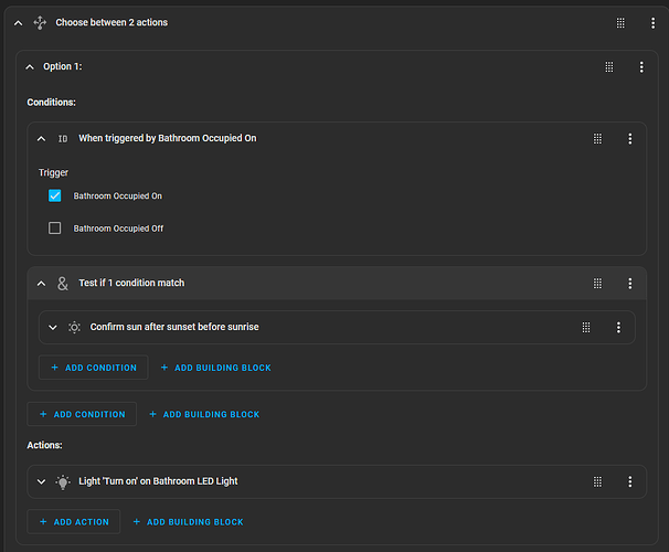

Setup the triggers in the automation at the top and edit the ID then use choose for the actions and inside of that use trigger by with an and with another trigger by then setup the action.
i.e this is for my nuc volume control but this is how I setup my automations for easier trigger and action groupings:
The and will be under that trigger by and you have that extra trigger by to pick from or use a device not in the when list.
i.e with an and condition:
