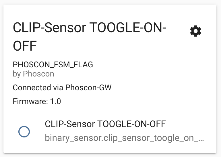

Since installing my new ComBee II USB, I have a sensor created I’m not sure where from.
Anyone got this or know what it is? Its showing OFF as state.
Not sure if the spelling ‘Toogle’ is a bug and meant to be ‘Toggle’?
Clip sensors are usually disabled by default. For some reason not in your case. You can disable it by going to.storage/core.config_entry and change clip sensor to false
I’ve got the same after some while ago. Noticed it after adding Aqara double rockers (but could be coincidence).
However its set to false for me:

Strange, mines set to false:
                "domain": "deconz",
                "entry_id": "beb0ae00d3ce4afbbb218244cc622730",
                "options": {
                    "allow_clip_sensor": false,
                    "allow_deconz_groups": true,
                    "master": true
                "source": "hassio",
                "title": "deCONZ-00212EFFFF0490DD",
                "version": 1
    "key": "core.config_entries",
    "version": 1
I did change it too true and restart - no change, changed it back to false - still the same.
Next step would be to share debug logs
ya sure, does that involve setting up dbg_??? in the config and if so what log level please.
Yes, there is an example of how to configure logging in deconz component documentation
Replying to myself here as figured it out. The devices I named with an apostrophe, ie Fred’s Window did not keep the name change on reboot or backup/restore or appear in the integration. Changed to Freds Window and works fine now.
