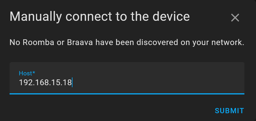

I just got a new Roomba i6 and I was delighted to see that there’s a HA integration for it. Unfortunately when I attempted to add the integration and set up my Roomba, I got errors during installation.

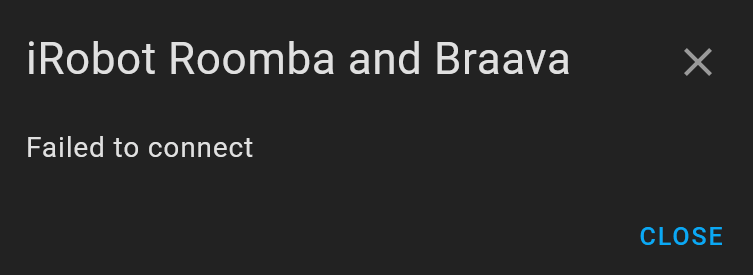

When I click “Add Integration” it seems to start the installation process successfully. During the “Connect Device” process, it is able to find my new Roomba so I can select it as a host from the drop-down list. It then asks me to hold down the home button on the Roomba and then hit submit. After following the instructions and clicking submit, the integration setup displays an “unknown error occurred” message and will not let me proceed further.

I assume this is the error that the integration setup GUI is hitting. I’ve seen some forum posts that post similar errors, but not quite the same, and none seem to solve the issue. Any ideas regarding this problem? Information regarding my setup is below.
