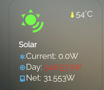

Trying to create a button that shows basic solar info. Stole a format normally used for system monitoring and adapting, but stumbling on issue with rounding. Prefer to have rounded to full watts and in some cases divide by 1000 to create KWH . How do I add this to the template? Rounding and or creating KWH from watts.
Screen Shot 2022-11-06 at 17.36.54
aspect_ratio: 1/1
custom_fields:
  solarc: |
      return `<ha-icon
        icon="mdi:sun-compass"
        style="width: 12px; height: 12px; color: deepskyblue;">
        </ha-icon><span>Current: <span style="color: var(--text-color-sensor);">${(states['sensor.benext_solar_electric_production_w'].state) } W</span></span>`
  solari: |
      return `<ha-icon
        icon="mdi:memory"
        </ha-icon><span>Day: <span style="color: var(--text-color-sensor);">${(states['sensor.solar_generated_new_watts'].state)} W</span></span>`
  solarn: |
      return `<ha-icon
        icon="mdi:harddisk"
        </ha-icon><span>Net: <span style="color: var(--text-color-sensor);">${states['sensor.solar_net_combined'].state}W</span></span>`
  temp: |
      return `<ha-icon
        icon="mdi:thermometer"
        style="width: 12px; height: 12px; color: yellow;">
        </ha-icon><span>${entity.state}°C</span>`
entity: sensor.192_168_1_36_core_0_temperature
icon: mdi:sun-wireless
styles:
  card:
    - background-color: var(--button-card-paper-card-background-color)
    - border-radius: 10%
    - padding: 10%
    - color: ivory
    - font-size: 14px
    - text-transform: capitalize
  custom_fields:
    solarc:
      - padding-bottom: 2px
      - align-self: middle
      - justify-self: start
      - '--text-color-sensor': >-
          [[[ if (states["sensor.benext_solar_electric_production_w"].state >
          80) return "red"; ]]]
    solari:
          [[[ if (states["sensor.solar_generated_new_watts"].state > 80) return
          "red"; ]]]
    solarn:
          [[[ if (states["sensor.solar_net_combined"].state > 80) return "red";
    temp:
      - align-self: start
      - justify-self: end
  grid:
    - grid-template-areas: '"i temp" "n n" "solarc solarc" "solari solari" "solarn solarn"'
    - grid-template-columns: 1fr 1fr
    - grid-template-rows: 1fr min-content min-content min-content min-content
  icon:
    - color: |
          if (entity.state < 60) return 'lime';
          if (entity.state >= 60 && entity.state < 80) return 'orange';
          else return 'red';
    - width: 70%
    - margin-top: '-10%'
  img_cell:
    - justify-content: start
    - align-items: start
    - margin: none
  name:
    - font-weight: bold
    - font-size: 13px
    - color: white
    - padding-bottom: 4px
type: custom:button-card

But here you can see my main problem. Why first is the button not a circle (play the gif):
ScreenVideo_20221123-193953
Thank you, Steffen
