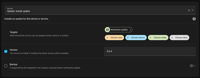

I dont know how to explain it better than what the warning message is telling you, but its saying you cant install that version of mushroom as its made for a newer version of HA than the one you are using.
the one mentioned 2024.8.0b0 is the beta release for the release coming out this wednesday. which is 2024.8.0.
so probably just wait until then? or select the previous version when downloading:
or as described you can call a service with the specific version number you want to install:
so the service call probably looks like this - but not sure, have never used it:
