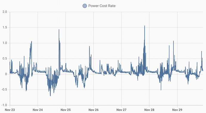

I quite like the execution of Amber Electric Smart Shift, but it isn’t available where I live so I have pulled together some Automations to deliver the same outcome. As these Automations are not specific to Amber Electric, they should be reusable for any provider where you can access the pricing, or even to manage consumption of excess solar.
In brief Amber is an Australian electricity retailer that provides access to wholesale electricity prices. Customers monitor the wholesale price and shift their energy usage to cheaper, greener times. This saves them money and supports the shift to a more renewably-powered Australia.
@madpilot has done a great job getting the Amber Electric Integration into HA core and my automations are based off that.
What I have done is setup three automations that Trigger off the sensor.amber_general_price; High Price (Red), OK Price (Yellow) and Low Price (Green) and which then call Actions to notify the pricing changes, and switch relevant devices on and off to match the price state.
