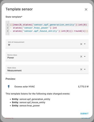

The CoolingFactor is in (W / °C) and is different for every household, depends on how big your AC is, how good is your insulation and thermal mass. For my household I find a cooling factor of 1500 W / °C works pretty well. I set up the CoolingFactor as an input_number helper.
I use a template calculate the helper to actual excess solar power available for HVAC.
