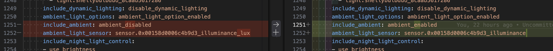

Copi pasted it…
And see what stupid difference it was:
I don’t know how that got there…
Thank you very much Blacky! I disabled the state control now and it’s working like it should now.
