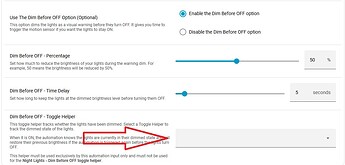

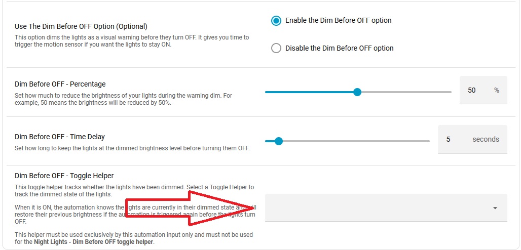

Hi! Thanks for the awesome blueprint. I am using it for a few months now.
Today i tried dynamic lighting with lux-controlled brightness. Currently, when the automation triggers, the light only turns on after the "Dynamic Lighting - Heartbeat" interval has passed. Is this expected behavior?
I want the light to turn on instantly when triggered, but I still want to keep a decent heartbeat interval (e.g., 1 minute) to adjust the brightness later. Is there a way to force an immediate update on the first trigger?
@flogi12
I should turn ON depending on your settings. If you could you please provide us your YAML of the automation? This YAML code are the settings you have selected in the automation so I can help. To do this go into your automation, top right 3 dots, Edit in YAML, copy all the code, come back to the forum and in your reply at the top tool bar click on “</>” and paste code in there.
Blacky :smiley:
Thanks for the fast response. I tried a few variants. This would be the preferred one:
alias: Licht Gästezimmer EG - Sensor Light
description: ""
use_blueprint:
  path: Blackshome/sensor-light.yaml
  input:
    motion_trigger:
      - binary_sensor.motion_gaestezimmer_eg_presence
    light_switch:
      entity_id: light.light_gaestezimmer_eg
    time_delay: 0
    include_bypass:
      - bypass_enabled_stop
    motion_bypass_lights_stop:
      - input_boolean.licht_gaestezimmer_eg_bypass
    include_dim_before_off: dim_before_off_enabled
    dim_before_off_pct: 50
    include_light_control:
      - use_brightness
    dim_before_off_time_delay: 5
    bypass_auto_off_delay: 15
    include_state_control: state_control_enabled
    state_control_entity: binary_sensor.sleep_mode_house
    include_night_lights: night_lights_disabled
    night_lights_conditions:
      - sun_enabled
    night_lights:
    include_night_light_control:
      - use_brightness
    night_time_delay: 0
    include_dynamic_lighting: enable_lux_controled_brightness_inv
    dynamic_lighting_lux_sensor: sensor.motion_gaestezimmer_eg_illuminance
    dynamic_lighting_min_brightness: 20
    dynamic_lighting_boolean: input_boolean.light_gaestezimmer_eg_dynamic_lighting
    dynamic_lighting_max_lux: 400
    dynamic_lighting_heartbeat: 1
    light_transition_on: 0
    light_transition_off: 0
    night_light_include_dim_before_off: dim_before_off_enabled
    night_light_dim_before_off_time_delay: 10
@flogi12
Thanks for your YAML. Your missing the dim before OFF toggle helper in light control. Add one in or disable this option and you bee good to go.

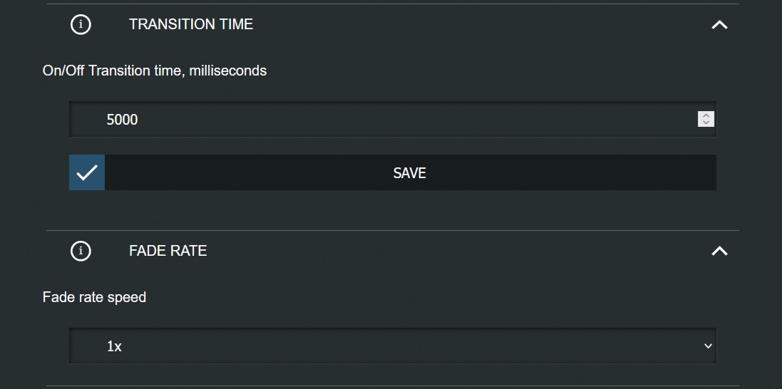

I'm really new to automations, and I very much appreciate your work creating this one, and even more so in supporting it.
My lights aren't dimming off. I have configured the automation with a sensor group (two Ikea Myggspray motion sensors, one at the top and one at the bottom of the stairs) as the Trigger, and a light group (three Ikea Kajplatt bulbs in the stair pendant light) as the Lights. I would like the lights to fade off over 10 seconds, so I configured the Light Control to Use Transition with a 0 second Transition - ON and a 10 second Transition - OFF.
The lights switch on with any motion, as expected. They stay on while the Myggspray sensors clear, as expected. Then they fade quickly, over less than a second.
The trace shows they take a path through the transition, but that's not how my lights behave. Looking at the source code, I see it expects a scene.
I've never worked with scenes before. Is this just a named scene so that the automation can save the previous state of my lights? Or do I need to make a scene specifically to store the off state? Or perhaps I've done something else incorrectly, and I don't actually need a scene at all.
How do I get my lights to fade off?

I’d appreciate that. Here’s my yaml:
alias: Stair presence lights
description: ""
use_blueprint:
  input:
    motion_trigger:
      - binary_sensor.stair_presence
    light_switch:
      entity_id: light.stair_lights
    time_delay: 0
      - use_transition
    light_transition_off: 10
@judebert
Thanks for your YAML. All your settings look good, and the blueprint will send the transition value to your light. There are a couple of things to keep in mind.
Not all lights support transitions in the same way. Some lights ignore the transition value sent by Home Assistant or use their own built-in settings instead. For example, I use Shelly dimmers, and the transition is controlled by the Shelly’s own settings. They only allow a maximum transition of 5 seconds (5000 milliseconds), so even if I set a 10 second transition in the blueprint, the light will only fade for up to 5 seconds.
In my case, I simply work within that limit. For example, I can set a 1 second transition for turning the light on and a 5 second transition for turning it off, and the Shelly will perform those transitions correctly. I just know that any transition longer than 5 seconds will be limited to 5 seconds by the dimmer.
This is Shelly settings
On the other hand, I also use WLED lights, which do support the transition value sent by Home Assistant. If I set a 10 second transition in the blueprint, the lights will fade over 10 seconds.
Have a look in your light settings and see what is possible for what you have.
Blacky :smiley:
Thanks, Blacky. These are Ikea white+color Kajplats bulbs; I know they support dimming, but I don’t know what transitions they support. Documentation is… sparse. I found some Kajplats Zigbee documentation on Github, which implies that transition works, but grabs control of the bulb while transitioning. I’m running it in Matter-over-Thread mode, and I don’t know if that changes anything.
Is there a way I can send commands to the light directly and see how it behaves?

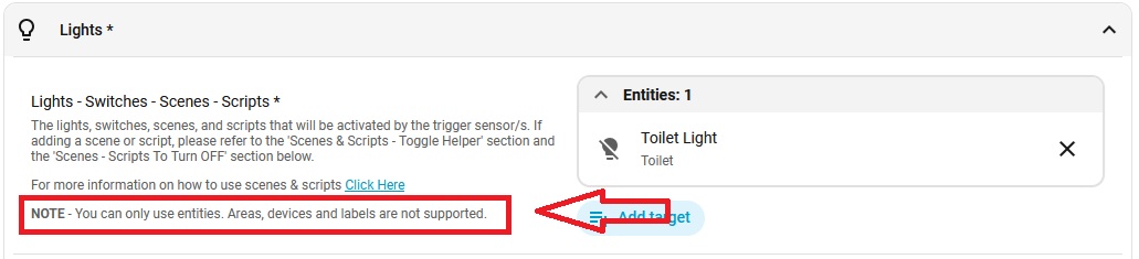

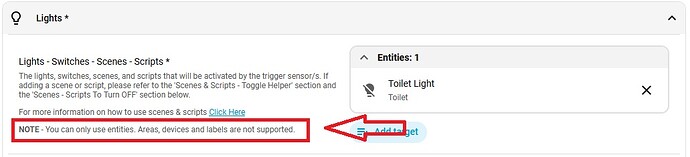

I’m also seeing an error since very recently. Was using it successfully since a while and just yesterday migrated all lights to Sensor Light 8.6 and now non of them seem to work unless I use entities as targets. Is this intended?
@Blacky
Edit: just read the response above, was not clear to me this is not supported. Is there a cleaner way to make it visible in the UI?
Error in logs:
Logger: homeassistant.components.automation.licht_auto_esstisch
Source: components/automation/__init__.py:715
Integration: Automation (documentation, issues)
First occurred: July 14, 2026 at 19:05:16 (80 occurrences)
Last logged: 23:38:31
Error rendering variables: UndefinedError: 'dict object' has no attribute 'entity_id'
@j8r
Then I have the first FAQ for this click here
I am glad you worked it out and your up an running.
